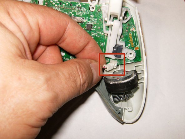

    • Here is a view of the inside of the controller. Note the vibration motors having different counter weights.
    • Remove the connector from the left motor (controller is positioned upside down, left controller will be shown right etc.)

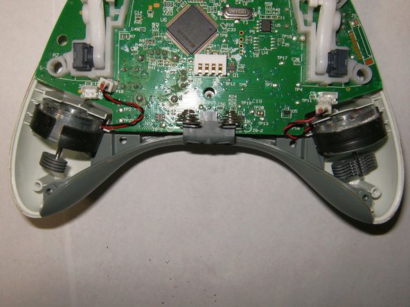

    • Remove the connector from the right motor
    • Both motors are disconnected. Notice position of the motors inside the case for re-assembly.
    • Remove logic board

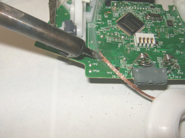

    • Apply some Flux on a desoldering wick
    • Unsolder the connections using a soldering iron and the wick.
    • Stay clear of the small SMD components that may surround the solder pads.

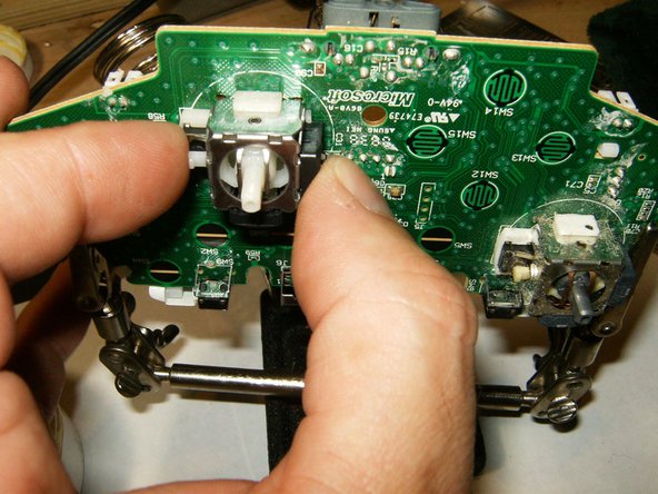

    • All contacts have been desoldered.
    • Gently try to remove the analog stick, making sure that all points can easily be moved off the board
    • If properly desoldered, the analog stick should clear the board without difficulty

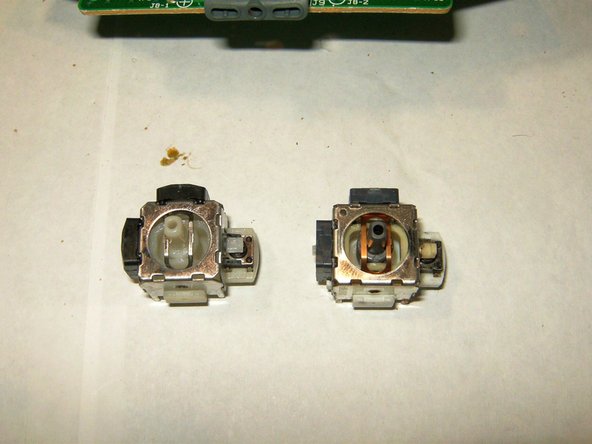

    • Always make sure that the replacement will fit. Make sure it has the same contacts and dimensions.
    • Place the new analog stick through the holes on the board. Make sure that it is flush with the board.
