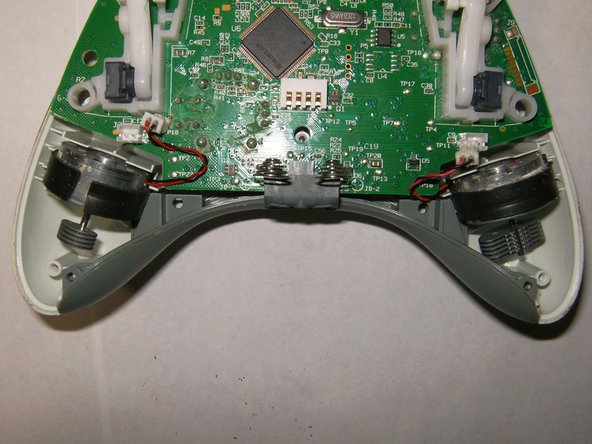

  3. Xbox 360 Wireless Controller Left Analog Stick Replacement: crwdns2935265:03crwdnd2935265:01crwdnd2935265:03crwdne2935265:0 Xbox 360 Wireless Controller Left Analog Stick Replacement: crwdns2935265:03crwdnd2935265:02crwdnd2935265:03crwdne2935265:0 Xbox 360 Wireless Controller Left Analog Stick Replacement: crwdns2935265:03crwdnd2935265:03crwdnd2935265:03crwdne2935265:0
    • Tilt the bottom case slightly toward the trigger buttons to slide it off the top case
    • Here is a view of the inside of the controller. Note the vibration motors having different counter weights.
    • Remove the connector from the left motor (controller is positioned upside down, left controller will be shown right etc.)
  4. Xbox 360 Wireless Controller Left Analog Stick Replacement: crwdns2935265:04crwdnd2935265:01crwdnd2935265:03crwdne2935265:0 Xbox 360 Wireless Controller Left Analog Stick Replacement: crwdns2935265:04crwdnd2935265:02crwdnd2935265:03crwdne2935265:0 Xbox 360 Wireless Controller Left Analog Stick Replacement: crwdns2935265:04crwdnd2935265:03crwdnd2935265:03crwdne2935265:0
    • Remove the connector from the right motor
    • Both motors are disconnected. Notice position of the motors inside the case for re-assembly.
    • Remove logic board

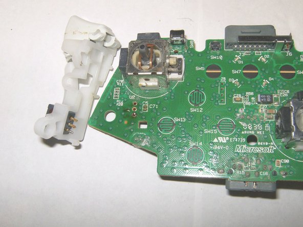

  6. Xbox 360 Wireless Controller Left Analog Stick Replacement: crwdns2935265:06crwdnd2935265:01crwdnd2935265:03crwdne2935265:0 Xbox 360 Wireless Controller Left Analog Stick Replacement: crwdns2935265:06crwdnd2935265:02crwdnd2935265:03crwdne2935265:0 Xbox 360 Wireless Controller Left Analog Stick Replacement: crwdns2935265:06crwdnd2935265:03crwdnd2935265:03crwdne2935265:0
    • To remove the left analog stick, the left trigger button will have to be removed first. Desolder the three solder points. Use desoldering wick and some flux to remove the solder.
    • Left trigger points unsoldered.
    • There are 2 snaps holding the left trigger piece in place, remove those. It may take a bit of force, but simply push the snap over and down.
  7. Xbox 360 Wireless Controller Left Analog Stick Replacement: crwdns2935265:07crwdnd2935265:01crwdnd2935265:03crwdne2935265:0 Xbox 360 Wireless Controller Left Analog Stick Replacement: crwdns2935265:07crwdnd2935265:02crwdnd2935265:03crwdne2935265:0 Xbox 360 Wireless Controller Left Analog Stick Replacement: crwdns2935265:07crwdnd2935265:03crwdnd2935265:03crwdne2935265:0
    • When removing the left trigger, make sure that the points are unsolderd properly, gently pull the trigger downward.
    • Left trigger removed.
    • With the left trigger removed, simply turn the logic board over and find the 14 solder connections
  8. Xbox 360 Wireless Controller Left Analog Stick Replacement: crwdns2935265:08crwdnd2935265:01crwdnd2935265:03crwdne2935265:0 Xbox 360 Wireless Controller Left Analog Stick Replacement: crwdns2935265:08crwdnd2935265:02crwdnd2935265:03crwdne2935265:0 Xbox 360 Wireless Controller Left Analog Stick Replacement: crwdns2935265:08crwdnd2935265:03crwdnd2935265:03crwdne2935265:0
    • Use a desoldering wick and some flux to remove the solder.
    • Ensure that no other components get either desoldered or otherwise heat damaged.
    • Here, all points have been desoldered.
