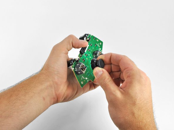

    1. Xbox 360 Wireless Controller Analog Stick Covers Replacement, Logic Board: crwdns2935265:09crwdnd2935265:01crwdnd2935265:02crwdne2935265:0 Xbox 360 Wireless Controller Analog Stick Covers Replacement, Logic Board: crwdns2935265:09crwdnd2935265:02crwdnd2935265:02crwdne2935265:0
      • Lifting from the headphone jack and power plug, remove the logic board from the front case.
    1. Xbox 360 Wireless Controller Analog Stick Covers Replacement, Analog Stick Covers: crwdns2935265:010crwdnd2935265:01crwdnd2935265:02crwdne2935265:0 Xbox 360 Wireless Controller Analog Stick Covers Replacement, Analog Stick Covers: crwdns2935265:010crwdnd2935265:02crwdnd2935265:02crwdne2935265:0
      • Grasp the right analog stick and pull the cover off its mount peg.
    2. Xbox 360 Wireless Controller Analog Stick Covers Replacement: crwdns2935265:011crwdnd2935265:01crwdnd2935265:02crwdne2935265:0 Xbox 360 Wireless Controller Analog Stick Covers Replacement: crwdns2935265:011crwdnd2935265:02crwdnd2935265:02crwdne2935265:0
      • Remove the left analog stick cover using the same procedure previously described.

unnecessary steps.
3 steps:
remove all 7 screws.
flip upside down remove top plate
pull stick caps off
reinstall in reverse.
you may have to slide the vibration motors into the slots on the top half when putting back together.
