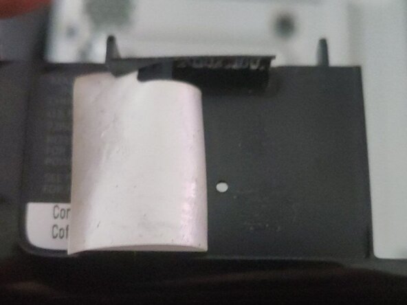

    • On the other side, take your flat head screwdriver and unlatch the latch. There is a harder latch farther inside so you have to stick the screwdriver far down and try to find it by feeling around. It helps to push both sides of your Xbox security sticker.
    • You can try detach bottom sticker and if you find a small hole, just put a thin screwdriver inside to push and unlatch the hard latch

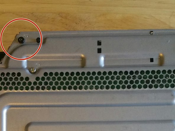

  11. Xbox 360 S Teardown: crwdns2935265:011crwdnd2935265:01crwdnd2935265:02crwdne2935265:0 Xbox 360 S Teardown: crwdns2935265:011crwdnd2935265:02crwdnd2935265:02crwdne2935265:0
    • Use your T8 and T10 Torque screwdriver and take out the five black screws that are shown in the picture.

i have the console and it was pretty easy to follow, the only thing was the last clip he was saying to just feel around for, i just pushed in on the spot where it would be and it separated easily after that

In the middle of the sticker on the back there is a pin hole to put something into to get the last clip off
