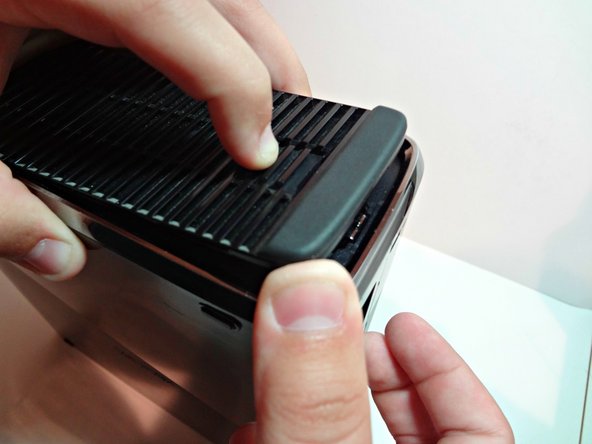

    • Flip the Xbox over and you will see three separate prongs. Pull those back and pull up, then you will see the hard drive. Pull the rectangle fabric piece up.
    • The hard drive should be removed.

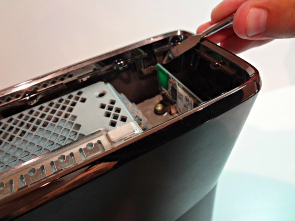

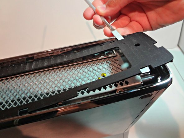

  2. Xbox 360 S Panel removal, Bottom Panel: crwdns2935265:02crwdnd2935265:01crwdnd2935265:03crwdne2935265:0 Xbox 360 S Panel removal, Bottom Panel: crwdns2935265:02crwdnd2935265:02crwdnd2935265:03crwdne2935265:0 Xbox 360 S Panel removal, Bottom Panel: crwdns2935265:02crwdnd2935265:03crwdnd2935265:03crwdne2935265:0
    • Move the Xbox with the hard drive facing toward the right.
    • Then insert your Metal Spudger in between the silver ring and the vent. You should here a pop noise which is the clip popping out.
    • Rotate the tool away from the Xbox prying open the bottom plate. Continue that step for all the remaining clips.

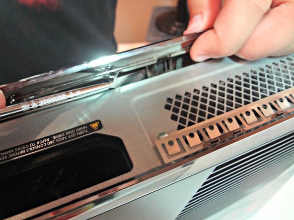

  3. Xbox 360 S Panel removal, Top Panel: crwdns2935265:03crwdnd2935265:01crwdnd2935265:03crwdne2935265:0 Xbox 360 S Panel removal, Top Panel: crwdns2935265:03crwdnd2935265:02crwdnd2935265:03crwdne2935265:0 Xbox 360 S Panel removal, Top Panel: crwdns2935265:03crwdnd2935265:03crwdnd2935265:03crwdne2935265:0
    • The top panel is very similar to the bottom panel removal. There will be thirteen clips you need to undo.
    • Make sure the front of the Xbox is facing towards the left. Then use the tool undo the clips just like you did on the bottom panel.
    • DO NOT BREAK ANY OF THE CLIPS.
