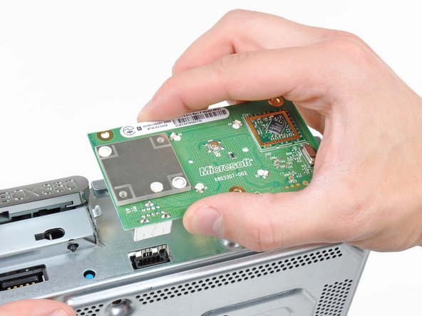

    1. Xbox 360 RF Module Replacement, RF Module: crwdns2935265:029crwdnd2935265:01crwdnd2935265:03crwdne2935265:0 Xbox 360 RF Module Replacement, RF Module: crwdns2935265:029crwdnd2935265:02crwdnd2935265:03crwdne2935265:0 Xbox 360 RF Module Replacement, RF Module: crwdns2935265:029crwdnd2935265:03crwdnd2935265:03crwdne2935265:0
      • Use the flat end of a spudger to release the clips securing the plastic RF module shield along the top and the left edge of the power button board.
      • Lift and remove the RF module shield from the console.
    2. Xbox 360 RF Module Replacement: crwdns2935265:030crwdnd2935265:01crwdnd2935265:01crwdne2935265:0
      • Remove three 5.6 mm T8 Torx screws securing the RF module to the metal chassis.
    3. Xbox 360 RF Module Replacement: crwdns2935265:031crwdnd2935265:01crwdnd2935265:02crwdne2935265:0 Xbox 360 RF Module Replacement: crwdns2935265:031crwdnd2935265:02crwdnd2935265:02crwdne2935265:0
      • Grasp the RF module and lift it straight up to disconnect it from its socket on the motherboard.
      • Remove the RF module from the console.
