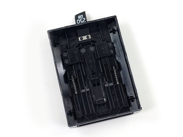

    • Just like the previous generation, the hard drive comes out easily with the help of a handy-dandy pull tab.
    • Speaking of "just like the previous generation," the 250 GB hard drive in our console is labeled as an Xbox 360 S hard drive.
    • Talk about cutting costs; Microsoft didn't even print new stickers to put on the E's hard drive case.
  5. Xbox 360 E Teardown: crwdns2935265:05crwdnd2935265:01crwdnd2935265:03crwdne2935265:0 Xbox 360 E Teardown: crwdns2935265:05crwdnd2935265:02crwdnd2935265:03crwdne2935265:0 Xbox 360 E Teardown: crwdns2935265:05crwdnd2935265:03crwdnd2935265:03crwdne2935265:0
    • If there's something we here at iFixit can't do, it's leave a "black box" alone.
    • We slice open the hard drive case to see who's providing the storage for our particular Xbox.
    • The 5400 RPM Seagate 250 GB hard drive is pretty cool, but we're more intrigued by what's underneath it.
    • Closer inspection shows that not only does the hard drive case have a pull tab, it has a spring-loaded pull tab.
    • A standard 2.5" SATA hard drive means I can safely upgrade my Xbox 360 E, right?
    • Unfortunately, no. Any attempt to "disassemble, decompile, create derivative works of, reverse engineer, or modify" hardware is a violation of the Xbox Live Terms of Use and may result in enforcement action.

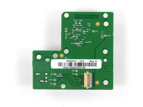

    • New to the 360 E, the front buttons are housed on their own separate board within the front panel, rather than residing on the RF module.
    • There's not much to admire on the button board, but Microsoft did take the effort to make sure their name was printed quite prominently on it.
    • The following buttons are located on the button board:
    • Power button (surrounded by LEDs for that characteristic glowing ring)
    • Disc tray eject button
    • Connect (wireless sync) button
  9. Xbox 360 E Teardown: crwdns2935265:09crwdnd2935265:01crwdnd2935265:03crwdne2935265:0 Xbox 360 E Teardown: crwdns2935265:09crwdnd2935265:02crwdnd2935265:03crwdne2935265:0 Xbox 360 E Teardown: crwdns2935265:09crwdnd2935265:03crwdnd2935265:03crwdne2935265:0
    • Unlike the hard drive, Microsoft redesigned, and even printed new stickers for, the Xbox 360 E's RF module.
    • The new module is labeled as model 1575, compared to the old model number 1409. That's 12% more model number!
    • While much of the board is largely unchanged, the absence of the power button backlight found in the Xbox 360 S is easily noticed.
    • Even Microsoft's X857052-001 IC is the same part from the 360 S' RF module.

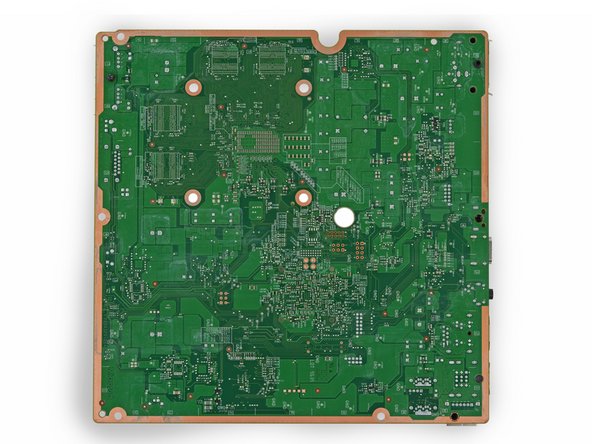

    • With the guts of the E cleared out of the way, we can finally gain access to its brain.
    • Disclaimer: Anatomical accuracy not guaranteed.
    • If you've ever been around an Xbox 360, chances are you've heard of the Red Ring of Death—a catastrophic failure originally believed to be caused by overheating (which we now know was caused by faulty GPU manufacturing) that was mostly seen in the "fat" revisions of the console.
    • Finally, after a drastic redesign to the processors and their heat sink in the Xbox 360 S, Microsoft seems to have the overheating issues under control, and is continuing to use the same cooling system in the 360 E.
    • With the heat sink unclamped and free to move about the cabin, we pop it off to take a gander at the processor.
  14. Xbox 360 E Teardown: crwdns2935265:014crwdnd2935265:01crwdnd2935265:02crwdne2935265:0 Xbox 360 E Teardown: crwdns2935265:014crwdnd2935265:02crwdnd2935265:02crwdne2935265:0
    • It's time to think inside the box. The prominent ICs found on the frontside of the motherboard:
    • GlobalFoundries (joint venture of AMD and ATIC) XCGPU SoC (combination of the Xenon CPU and the Xenos X818337 GPU onto the same die, with eDRAM in the same package)
    • Microsoft X850744-004 south bridge
    • Hynix HY27US08281A 128 Mb NAND flash
    • Samsung K4J10324KG-HC14 1 Gb GDDR3 SDRAM (total of four = 4 Gb)
    • On the backside...
    • A green land flecked with gold and the hopes of the internet-free gamers of tomorrow.
