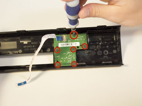

  13. Xbox 360 E Button Board Replacement, Button Board: crwdns2935265:013crwdnd2935265:01crwdnd2935265:03crwdne2935265:0 Xbox 360 E Button Board Replacement, Button Board: crwdns2935265:013crwdnd2935265:02crwdnd2935265:03crwdne2935265:0 Xbox 360 E Button Board Replacement, Button Board: crwdns2935265:013crwdnd2935265:03crwdnd2935265:03crwdne2935265:0
    • Rotate the front panel so you are looking at the inside of the piece.
    • Unscrew the six 6 mm screws with the T6 Torx screwdriver.
    • Carefully pull the green plate up and off to remove it.
