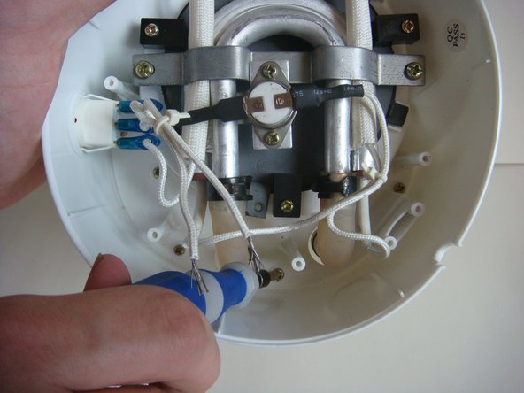

  3. XQ-673H Water Tubes Replacement: crwdns2935265:03crwdnd2935265:01crwdnd2935265:02crwdne2935265:0 XQ-673H Water Tubes Replacement: crwdns2935265:03crwdnd2935265:02crwdnd2935265:02crwdne2935265:0
    • Using a Phillips #1 screwdriver, remove the six 12mm screws.
    • Some screws are not visible from this photo, but their location is highlighted by the circles.

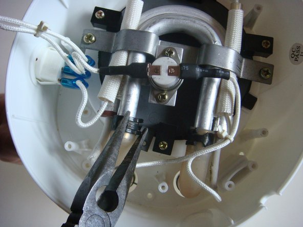

  4. XQ-673H Water Tubes Replacement: crwdns2935265:04crwdnd2935265:01crwdnd2935265:03crwdne2935265:0 XQ-673H Water Tubes Replacement: crwdns2935265:04crwdnd2935265:02crwdnd2935265:03crwdne2935265:0 XQ-673H Water Tubes Replacement: crwdns2935265:04crwdnd2935265:03crwdnd2935265:03crwdne2935265:0
    • Using small needle nose pliers, squeeze the metal that is covering the tube.
    • Carefully slide down the metal covering.
    • Repeat this step for the other tube.

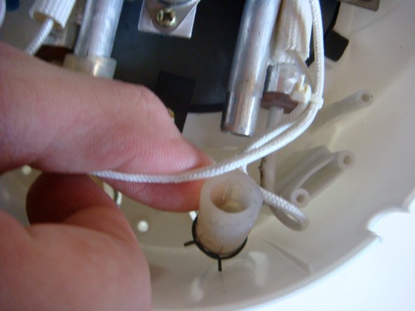

  5. XQ-673H Water Tubes Replacement: crwdns2935265:05crwdnd2935265:01crwdnd2935265:02crwdne2935265:0 XQ-673H Water Tubes Replacement: crwdns2935265:05crwdnd2935265:02crwdnd2935265:02crwdne2935265:0
    • Using your fingers, gently slide off the Water Tubes.

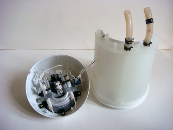

  6. XQ-673H Water Tubes Replacement: crwdns2935265:06crwdnd2935265:01crwdnd2935265:02crwdne2935265:0 XQ-673H Water Tubes Replacement: crwdns2935265:06crwdnd2935265:02crwdnd2935265:02crwdne2935265:0
    • Carefully lift the bottom section off the device.

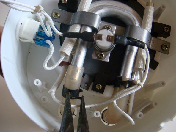

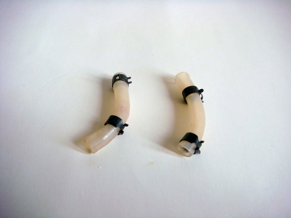

  7. XQ-673H Water Tubes Replacement: crwdns2935265:07crwdnd2935265:01crwdnd2935265:02crwdne2935265:0 XQ-673H Water Tubes Replacement: crwdns2935265:07crwdnd2935265:02crwdnd2935265:02crwdne2935265:0
    • Remove both of the Water Tubes completely.
