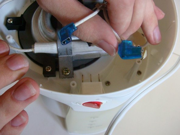

  3. XQ-673H Power Switch Replacement: crwdns2935265:03crwdnd2935265:01crwdnd2935265:02crwdne2935265:0 XQ-673H Power Switch Replacement: crwdns2935265:03crwdnd2935265:02crwdnd2935265:02crwdne2935265:0
    • Using a Plastic Opening Tool, carefully slide back the three power connectors for the Power Switch until fully removed.

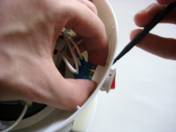

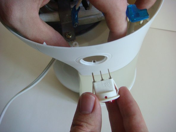

  4. XQ-673H Power Switch Replacement: crwdns2935265:04crwdnd2935265:01crwdnd2935265:03crwdne2935265:0 XQ-673H Power Switch Replacement: crwdns2935265:04crwdnd2935265:02crwdnd2935265:03crwdne2935265:0 XQ-673H Power Switch Replacement: crwdns2935265:04crwdnd2935265:03crwdnd2935265:03crwdne2935265:0
    • Gently squeeze the sides of the Power Switch, while using a Spudger to help pop out the Power Switch.
