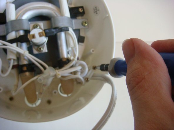

  2. XQ-673H Power Cord Replacement: crwdns2935265:02crwdnd2935265:01crwdnd2935265:03crwdne2935265:0 XQ-673H Power Cord Replacement: crwdns2935265:02crwdnd2935265:02crwdnd2935265:03crwdne2935265:0 XQ-673H Power Cord Replacement: crwdns2935265:02crwdnd2935265:03crwdnd2935265:03crwdne2935265:0
    • Using a phillips #1 screwdriver, remove the six 10mm screws found on the bottom of the device.
    • Remove the bottom cover.

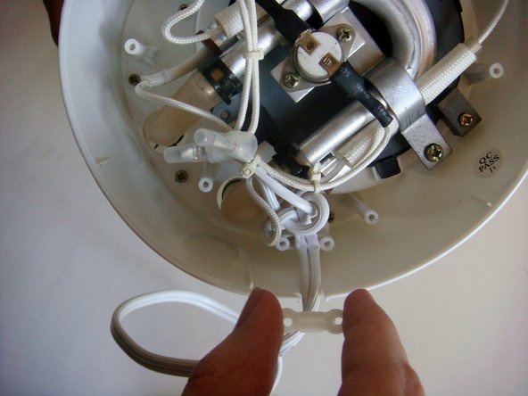

  3. XQ-673H Power Cord Replacement: crwdns2935265:03crwdnd2935265:01crwdnd2935265:03crwdne2935265:0 XQ-673H Power Cord Replacement: crwdns2935265:03crwdnd2935265:02crwdnd2935265:03crwdne2935265:0 XQ-673H Power Cord Replacement: crwdns2935265:03crwdnd2935265:03crwdnd2935265:03crwdne2935265:0
    • Using a Phillips #1 screwdriver, unscrew the 11mm screws.
    • Remove the plastic bar that is holding the Power Cord down.

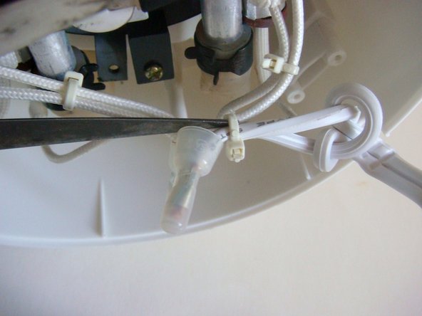

  4. XQ-673H Power Cord Replacement: crwdns2935265:04crwdnd2935265:01crwdnd2935265:02crwdne2935265:0 XQ-673H Power Cord Replacement: crwdns2935265:04crwdnd2935265:02crwdnd2935265:02crwdne2935265:0
    • Using scissors, carefully cut the zip tie.
    • Careful not to cut the Power Cord.

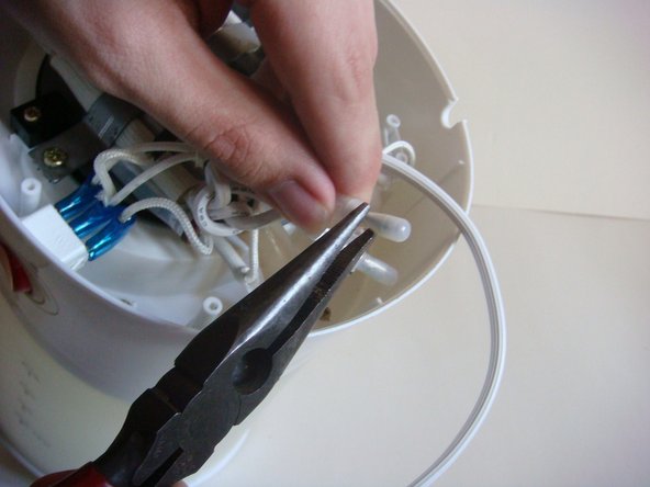

  5. XQ-673H Power Cord Replacement: crwdns2935265:05crwdnd2935265:01crwdnd2935265:03crwdne2935265:0 XQ-673H Power Cord Replacement: crwdns2935265:05crwdnd2935265:02crwdnd2935265:03crwdne2935265:0 XQ-673H Power Cord Replacement: crwdns2935265:05crwdnd2935265:03crwdnd2935265:03crwdne2935265:0
    • Using small needle nose pliers, gently squeeze the side so it allows the metal clamp to open up.
    • Gently pull off the plastic cover.
    • Repeat this step with the other plastic cover.

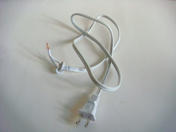

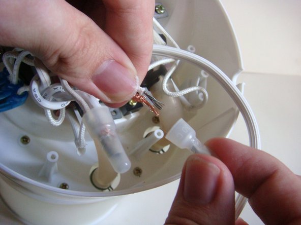

  6. XQ-673H Power Cord Replacement: crwdns2935265:06crwdnd2935265:01crwdnd2935265:02crwdne2935265:0 XQ-673H Power Cord Replacement: crwdns2935265:06crwdnd2935265:02crwdnd2935265:02crwdne2935265:0
    • Remove the Power Cord from the device.
