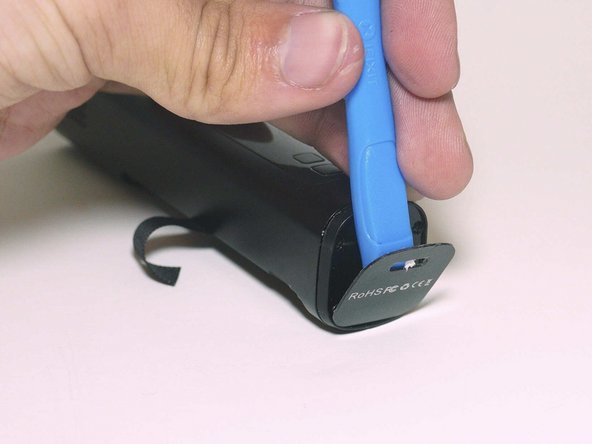

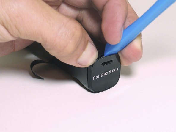

  3. XMAX V3 Pro Disassembly, Bottom Cover: crwdns2935265:03crwdnd2935265:01crwdnd2935265:03crwdne2935265:0 XMAX V3 Pro Disassembly, Bottom Cover: crwdns2935265:03crwdnd2935265:02crwdnd2935265:03crwdne2935265:0 XMAX V3 Pro Disassembly, Bottom Cover: crwdns2935265:03crwdnd2935265:03crwdnd2935265:03crwdne2935265:0
    • Apply heat from a hair dryer to help soften the glue
    • Use a spudger to pry off bottom cover
    • This might result in physical damage of the plastic bottom and cover by deforming the material

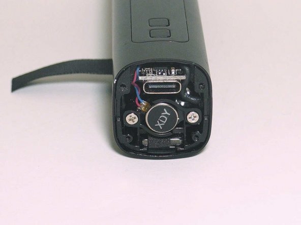

  4. XMAX V3 Pro Disassembly, Bottom Screws: crwdns2935265:04crwdnd2935265:01crwdnd2935265:02crwdne2935265:0 XMAX V3 Pro Disassembly, Bottom Screws: crwdns2935265:04crwdnd2935265:02crwdnd2935265:02crwdne2935265:0
    • Remove four PH000 screws
    • Remove plastic cover

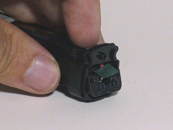

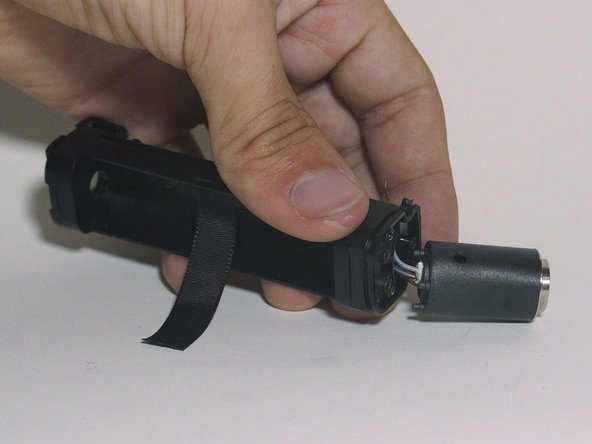

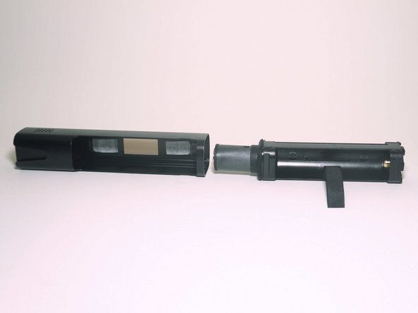

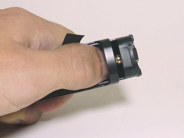

  5. XMAX V3 Pro Disassembly, Assembly Removal: crwdns2935265:05crwdnd2935265:01crwdnd2935265:03crwdne2935265:0 XMAX V3 Pro Disassembly, Assembly Removal: crwdns2935265:05crwdnd2935265:02crwdnd2935265:03crwdne2935265:0 XMAX V3 Pro Disassembly, Assembly Removal: crwdns2935265:05crwdnd2935265:03crwdnd2935265:03crwdne2935265:0
    • Use your thumb to apple pressure in the direction of the arrow
    • The entire assembly should slide out of the metal case

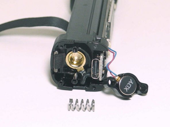

  6. XMAX V3 Pro Disassembly, Vibration Motor Screws: crwdns2935265:06crwdnd2935265:01crwdnd2935265:01crwdne2935265:0
    • Remove both P00 Screws
  7. XMAX V3 Pro Disassembly, Vibration Motor Removal: crwdns2935265:07crwdnd2935265:01crwdnd2935265:03crwdne2935265:0 XMAX V3 Pro Disassembly, Vibration Motor Removal: crwdns2935265:07crwdnd2935265:02crwdnd2935265:03crwdne2935265:0 XMAX V3 Pro Disassembly, Vibration Motor Removal: crwdns2935265:07crwdnd2935265:03crwdnd2935265:03crwdne2935265:0

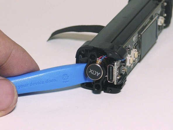

    • Use a spudger to remove the vibration motor and spring

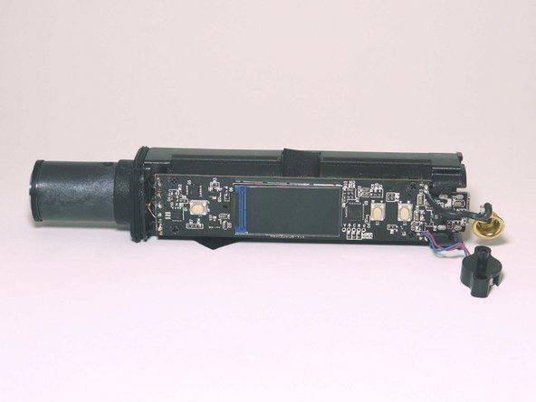

  8. XMAX V3 Pro Disassembly, Airflow Overview: crwdns2935265:08crwdnd2935265:01crwdnd2935265:02crwdne2935265:0 XMAX V3 Pro Disassembly, Airflow Overview: crwdns2935265:08crwdnd2935265:02crwdnd2935265:02crwdne2935265:0
    • Here is an overview of the internal assembly on top of the metal case so you can see the airpath
    • The rubber gasket that can be seen better in step 11 stops air from entering the heating assembly from the motherboard area and only allows it to be drawn in the the side perforations.
    • Air enters though the area within the red square and then goes though the hole within the red circle

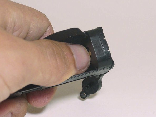

  9. XMAX V3 Pro Disassembly, Negative Battery Contact Removal: crwdns2935265:09crwdnd2935265:01crwdnd2935265:02crwdne2935265:0 XMAX V3 Pro Disassembly, Negative Battery Contact Removal: crwdns2935265:09crwdnd2935265:02crwdnd2935265:02crwdne2935265:0

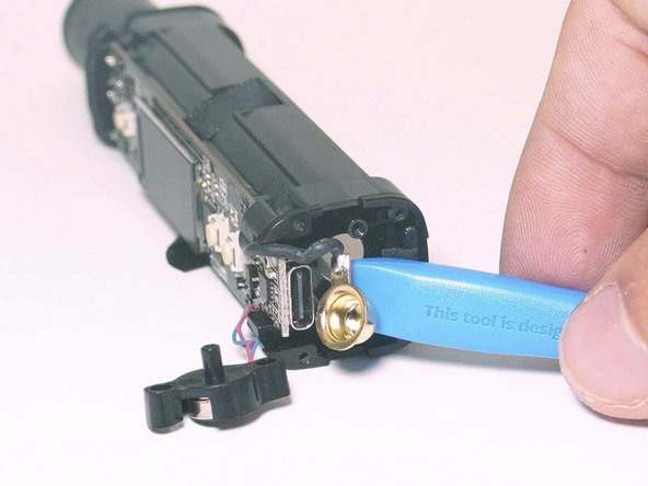

    • Use your thumb to push in the gold contact
  10. XMAX V3 Pro Disassembly, Continued Removal of Negative Terminal: crwdns2935265:010crwdnd2935265:01crwdnd2935265:03crwdne2935265:0 XMAX V3 Pro Disassembly, Continued Removal of Negative Terminal: crwdns2935265:010crwdnd2935265:02crwdnd2935265:03crwdne2935265:0 XMAX V3 Pro Disassembly, Continued Removal of Negative Terminal: crwdns2935265:010crwdnd2935265:03crwdnd2935265:03crwdne2935265:0
    • Use a spudger to completely remove the gold battery contact from case

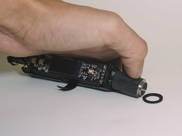

  12. XMAX V3 Pro Disassembly, O-ring Removal: crwdns2935265:012crwdnd2935265:01crwdnd2935265:02crwdne2935265:0 XMAX V3 Pro Disassembly, O-ring Removal: crwdns2935265:012crwdnd2935265:02crwdnd2935265:02crwdne2935265:0
    • Remove rubber o-ring

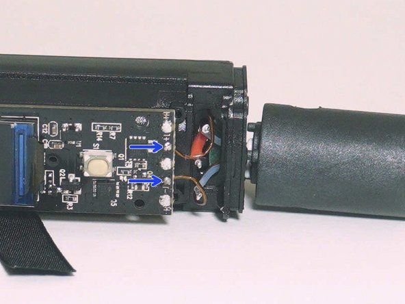

  14. XMAX V3 Pro Disassembly, Desolding of Heater Assembly: crwdns2935265:014crwdnd2935265:01crwdnd2935265:03crwdne2935265:0 XMAX V3 Pro Disassembly, Desolding of Heater Assembly: crwdns2935265:014crwdnd2935265:02crwdnd2935265:03crwdne2935265:0 XMAX V3 Pro Disassembly, Desolding of Heater Assembly: crwdns2935265:014crwdnd2935265:03crwdnd2935265:03crwdne2935265:0
    • Desolder positive battery terminal and both heater wires
    • Desolder both temperature probe wires

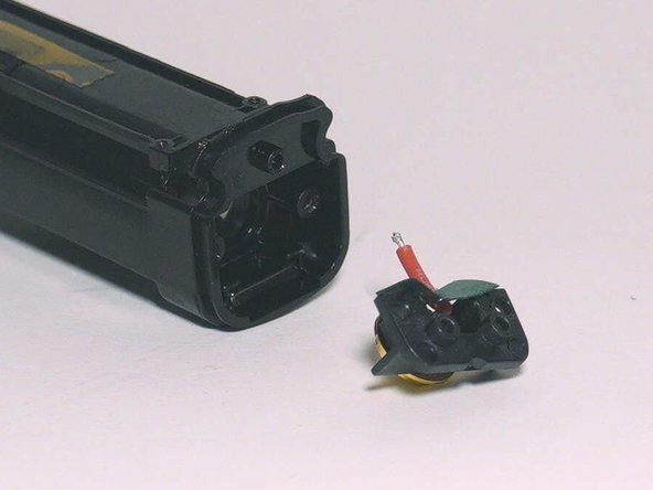

  16. XMAX V3 Pro Disassembly, Positive Battery Terminal Assembly: crwdns2935265:016crwdnd2935265:01crwdnd2935265:03crwdne2935265:0 XMAX V3 Pro Disassembly, Positive Battery Terminal Assembly: crwdns2935265:016crwdnd2935265:02crwdnd2935265:03crwdne2935265:0 XMAX V3 Pro Disassembly, Positive Battery Terminal Assembly: crwdns2935265:016crwdnd2935265:03crwdnd2935265:03crwdne2935265:0
    • Remove both P000 screws
    • Pull out positive battery terminal assembly

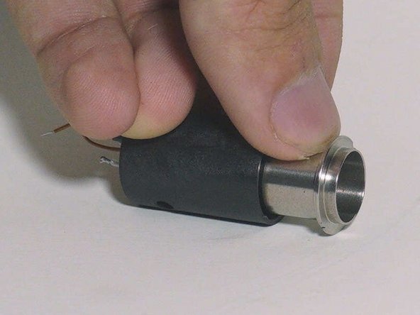

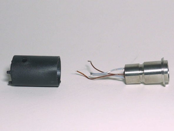

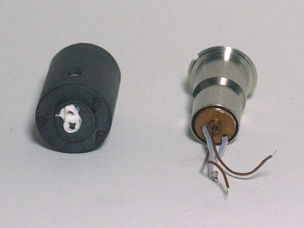

  17. XMAX V3 Pro Disassembly, Heater Core: crwdns2935265:017crwdnd2935265:01crwdnd2935265:03crwdne2935265:0 XMAX V3 Pro Disassembly, Heater Core: crwdns2935265:017crwdnd2935265:02crwdnd2935265:03crwdne2935265:0 XMAX V3 Pro Disassembly, Heater Core: crwdns2935265:017crwdnd2935265:03crwdnd2935265:03crwdne2935265:0
    • Use a nail or spudger to remove the heater core from the outside housing
    • There will be some epoxy on the bottom of the casing that is securing the wires
    • This epoxy needs to be placed before reassembling the device. It stops air from the electronics and motherboard area from entering your mouth.
  18. XMAX V3 Pro Disassembly, More Heater Assembly Pictures: crwdns2935265:018crwdnd2935265:01crwdnd2935265:02crwdne2935265:0 XMAX V3 Pro Disassembly, More Heater Assembly Pictures: crwdns2935265:018crwdnd2935265:02crwdnd2935265:02crwdne2935265:0
    • Some more photos of the heater assembly

I wonder how the air gets inside the heater core, it does not seem to have any holes!
