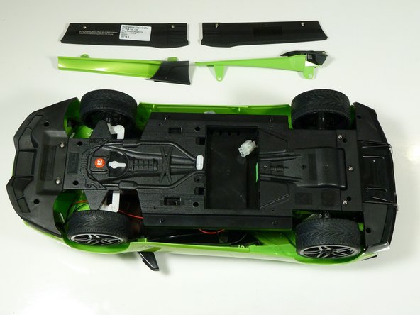

  5. X-street Lamborghini Murcielago LP670-4 SV Steering Column Spring Replacement: crwdns2935265:05crwdnd2935265:01crwdnd2935265:02crwdne2935265:0 X-street Lamborghini Murcielago LP670-4 SV Steering Column Spring Replacement: crwdns2935265:05crwdnd2935265:02crwdnd2935265:02crwdne2935265:0
    • Lift up and remove the two side skirts.

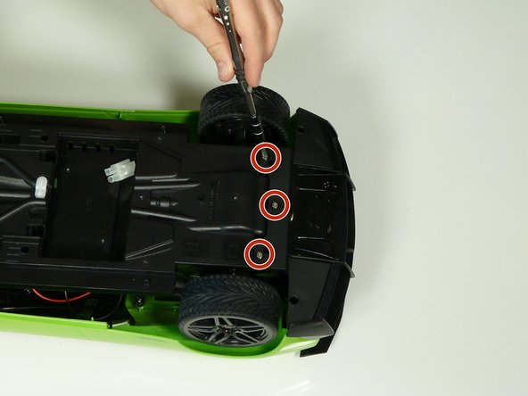

  8. X-street Lamborghini Murcielago LP670-4 SV Steering Column Spring Replacement: crwdns2935265:08crwdnd2935265:01crwdnd2935265:02crwdne2935265:0 X-street Lamborghini Murcielago LP670-4 SV Steering Column Spring Replacement: crwdns2935265:08crwdnd2935265:02crwdnd2935265:02crwdne2935265:0
    • Unscrew the remaining seven 9mm Phillips #00 screws from the underbody of the car.
    • The second image shows a closer view of the rear three screws

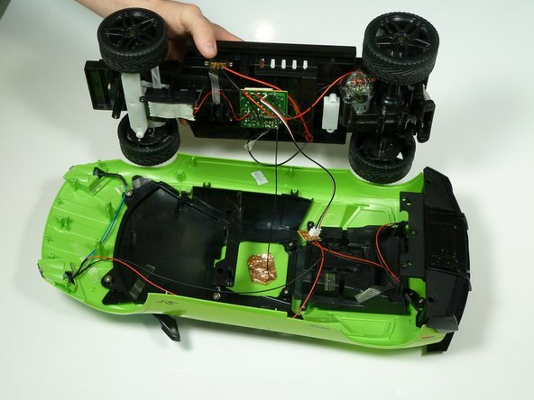

  9. X-street Lamborghini Murcielago LP670-4 SV Steering Column Spring Replacement: crwdns2935265:09crwdnd2935265:01crwdnd2935265:02crwdne2935265:0 X-street Lamborghini Murcielago LP670-4 SV Steering Column Spring Replacement: crwdns2935265:09crwdnd2935265:02crwdnd2935265:02crwdne2935265:0
    • Lift the main underbody from the shell of the car.
    • Lift up the body to expose the wiring and hardware underneath.

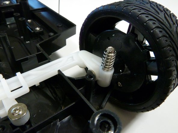

  13. X-street Lamborghini Murcielago LP670-4 SV Steering Column Spring Replacement, Steering Column Spring: crwdns2935265:013crwdnd2935265:01crwdnd2935265:01crwdne2935265:0
    • Remove the three 1.6mm Phillips #000 screws from the black motor casing.
  14. X-street Lamborghini Murcielago LP670-4 SV Steering Column Spring Replacement: crwdns2935265:014crwdnd2935265:01crwdnd2935265:01crwdne2935265:0
    • Remove the front motor and its casing from the chassis of the car.
  15. X-street Lamborghini Murcielago LP670-4 SV Steering Column Spring Replacement: crwdns2935265:015crwdnd2935265:01crwdnd2935265:01crwdne2935265:0
    • Carefully remove the steering column spring.
