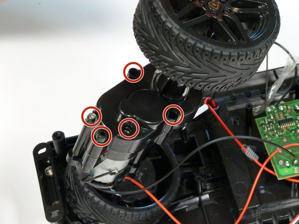

  12. X-street Lamborghini Murcielago LP670-4 SV Rear Motor Replacement, Rear Motor: crwdns2935265:012crwdnd2935265:01crwdnd2935265:01crwdne2935265:0
    • Unscrew the two 2.5mm Phillips #00 screws on the white covering of the rear motor casing.
    • There is a plastic casing over the rear motor. Simply remove this plastic covering and proceed.
  13. X-street Lamborghini Murcielago LP670-4 SV Rear Motor Replacement: crwdns2935265:013crwdnd2935265:01crwdnd2935265:02crwdne2935265:0 X-street Lamborghini Murcielago LP670-4 SV Rear Motor Replacement: crwdns2935265:013crwdnd2935265:02crwdnd2935265:02crwdne2935265:0
    • Remove all ten 1.6mm Phillips #000 screws from the rear motor casing
    • The first image shows five screws on the side with the circuitry
    • The second image shows five screws on the opposite side of the casing.
