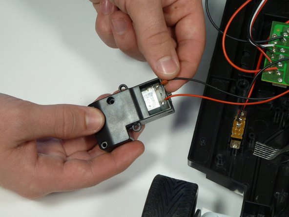

  13. X-street Lamborghini Murcielago LP670-4 SV Front Steering Motor Replacement, Front Steering Motor: crwdns2935265:013crwdnd2935265:01crwdnd2935265:01crwdne2935265:0
    • Remove the three 1.6mm Phillips #000 screws from the black motor casing
  14. X-street Lamborghini Murcielago LP670-4 SV Front Steering Motor Replacement: crwdns2935265:014crwdnd2935265:01crwdnd2935265:01crwdne2935265:0
    • Remove the front motor and its casing from the chassis of the car.
  15. X-street Lamborghini Murcielago LP670-4 SV Front Steering Motor Replacement: crwdns2935265:015crwdnd2935265:01crwdnd2935265:02crwdne2935265:0 X-street Lamborghini Murcielago LP670-4 SV Front Steering Motor Replacement: crwdns2935265:015crwdnd2935265:02crwdnd2935265:02crwdne2935265:0
    • Remove the remaining three 1.6 mm Phillips #000 screws from the black motor casing
    • The second image shows the screws removed from the casing.
  16. X-street Lamborghini Murcielago LP670-4 SV Front Steering Motor Replacement: crwdns2935265:016crwdnd2935265:01crwdnd2935265:01crwdne2935265:0
    • Pull out the front motor, making sure to keep the gears intact
