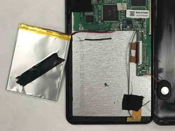

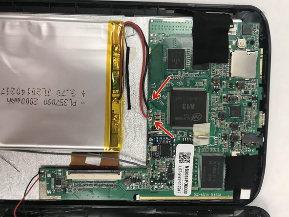

    • Pull the cloth tape from the battery to free the body of the battery.
    • Use a solder vacuum and soldering iron to release the red, and then the black, wire from the motherboard.
  3. X-Treme Tablet Generation 2 Battery Replacement: crwdns2935265:03crwdnd2935265:01crwdnd2935265:02crwdne2935265:0 X-Treme Tablet Generation 2 Battery Replacement: crwdns2935265:03crwdnd2935265:02crwdnd2935265:02crwdne2935265:0
    • Remove the battery from the device.
    • Insert the new 3.7 V Li-Polymer battery into the device.
    • Use the soldering iron to solder the red, and then the black, wire back to motherboard.
