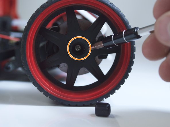

    • Remove the wheel hub cap with a pry tool.
    • Remove the wheel. Take out the one 3mm Phillips #2 screw that connects the wheel to the wheel and motor assembly

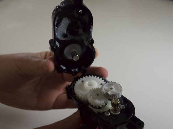

    • Pull apart the motor housing gently.
    • Keep in mind there are loose, fragile components inside.
  11. X-Street STR Viper Motor Replacement: crwdns2935265:011crwdnd2935265:01crwdnd2935265:02crwdne2935265:0 X-Street STR Viper Motor Replacement: crwdns2935265:011crwdnd2935265:02crwdnd2935265:02crwdne2935265:0

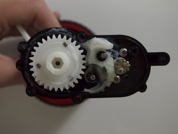

    • Before you attempt this step, keep in mind that these gears have grease on them.
    • Remove the two smaller gears by gently pulling them out of the motor housing.

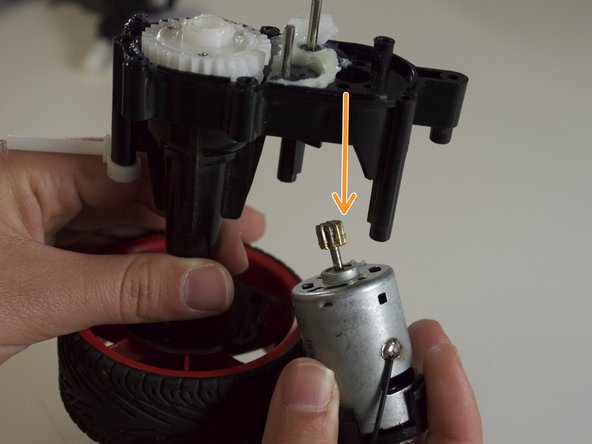

    • Remove the two 6mm Phillips #2 screws located on either side of the small brass gear.
    • After removing the screws, remove motor by pulling it down and out of the housing.

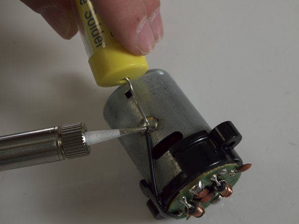

    • Detach the black wire that is attached to the outer shell of the motor itself. Use a soldering iron or wire cutters—not scissors as shown in photo.
    • Using these desoldering techniques, remove the solder.

    • Pull apart the motor housing with care and clip off the wires that are soldered on to the motor.
    • Re-Solder the two wires back on to the motor when replaced. Refer to this How To Solder guide for more information.
    • Be sure to keep the circuit board and gear in order to re-attach them to the new motor.
