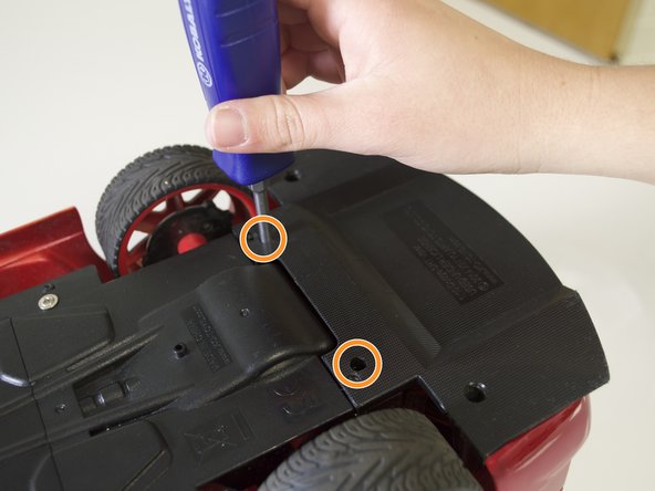

    • Remove the two 6 mm screws and the two 3 mm screws that connect the back panel to the main underside panel.
    • Remove the two 6 mm screws that connect the rear panel to the body of the car.

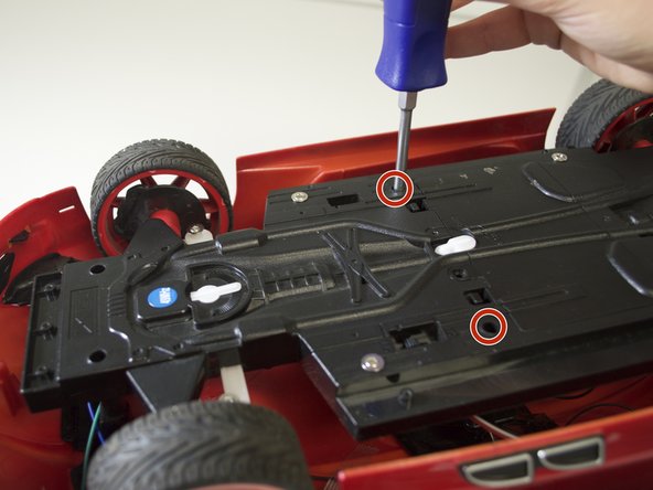

  4. X-Street STR Viper Motherboard Replacement: crwdns2935265:04crwdnd2935265:01crwdnd2935265:03crwdne2935265:0 X-Street STR Viper Motherboard Replacement: crwdns2935265:04crwdnd2935265:02crwdnd2935265:03crwdne2935265:0 X-Street STR Viper Motherboard Replacement: crwdns2935265:04crwdnd2935265:03crwdnd2935265:03crwdne2935265:0
    • Remove the two front 6 mm screws and the two middle 6 mm screws.
    • Remove the main underside panel carefully. Excessive force could damage or disconnect the fragile wires attached to this piece.

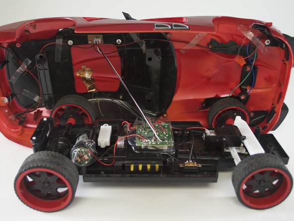

    • Remove the car shell and place it on the left side of the car.
  5. X-Street STR Viper Motherboard Replacement, Motherboard: crwdns2935265:05crwdnd2935265:01crwdnd2935265:01crwdne2935265:0
    • Make sure the car is turned off before proceeding to any other steps.
    • Remove the top body of the car from the bottom. Unplug the light connector. Be careful not to pull any of the wires too hard.

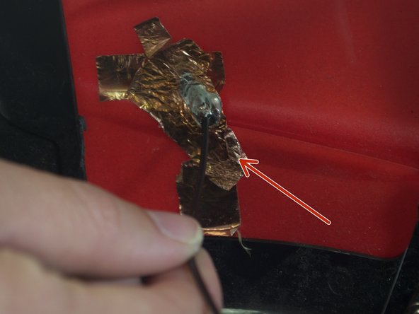

  6. X-Street STR Viper Motherboard Replacement: crwdns2935265:06crwdnd2935265:01crwdnd2935265:01crwdne2935265:0
    • Remove the electrical tape. It is connected to the top part of car. This allows you to fully take the car apart.
