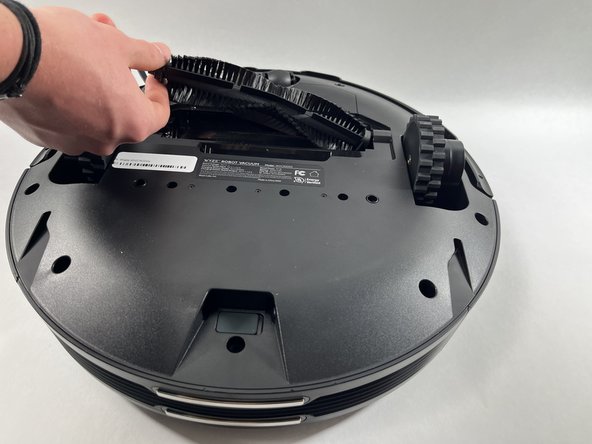

    • Flip the vacuum upside down so the bottom is facing up.
    • In the center of the device, you should see the rotating brush that stretches from one wheel to the other.
  2. Wyze WVCR200s Battery Replacement: crwdns2935265:02crwdnd2935265:01crwdnd2935265:02crwdne2935265:0 Wyze WVCR200s Battery Replacement: crwdns2935265:02crwdnd2935265:02crwdnd2935265:02crwdne2935265:0
    • Pinch the blue tabs below the rotating brush towards each other.
    • Lift the plastic housing surrounding the rotating brushing straight up, and the remove it from the vacuum.
  3. Wyze WVCR200s Battery Replacement: crwdns2935265:03crwdnd2935265:01crwdnd2935265:03crwdne2935265:0 Wyze WVCR200s Battery Replacement: crwdns2935265:03crwdnd2935265:02crwdnd2935265:03crwdne2935265:0 Wyze WVCR200s Battery Replacement: crwdns2935265:03crwdnd2935265:03crwdnd2935265:03crwdne2935265:0

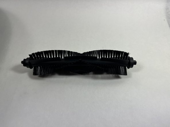

    • To remove the rotating brush, lift one end of the brush upwards, and remove.

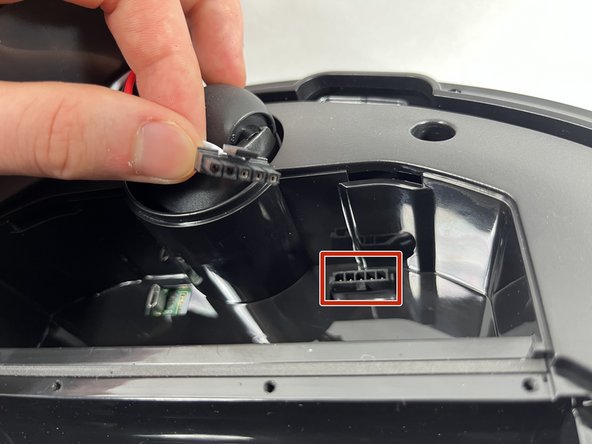

    • Lift the battery out from underneath the cover.
    • Be careful not to pull or yank the battery out, it is connected by wires to the vacuum port.
    • Carefully disconnect the battery from the vacuum port.
