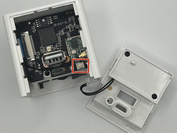

  3. Wyze Cam V2 Camera Replacement: crwdns2935265:03crwdnd2935265:01crwdnd2935265:02crwdne2935265:0 Wyze Cam V2 Camera Replacement: crwdns2935265:03crwdnd2935265:02crwdnd2935265:02crwdne2935265:0
    • Open up the back panel using the iFixit opening tool and unclip the panel from the rest of the device.
    • Be careful of the charging port while taking it off.
