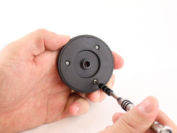

  4. WowWee MiP Robot Tire Replacement, Tires: crwdns2935265:04crwdnd2935265:01crwdnd2935265:02crwdne2935265:0 WowWee MiP Robot Tire Replacement, Tires: crwdns2935265:04crwdnd2935265:02crwdnd2935265:02crwdne2935265:0
    • Remove the three 7.7 mm Phillips #1 screws.
  5. WowWee MiP Robot Tire Replacement: crwdns2935265:05crwdnd2935265:01crwdnd2935265:03crwdne2935265:0 WowWee MiP Robot Tire Replacement: crwdns2935265:05crwdnd2935265:02crwdnd2935265:03crwdne2935265:0 WowWee MiP Robot Tire Replacement: crwdns2935265:05crwdnd2935265:03crwdnd2935265:03crwdne2935265:0
    • Separate the rubber tire from the rim.
    • Push the collar out to separate the plastic layers of the wheel.
    • When reassembling, align the groove and the key of the two wheels' halves together.
