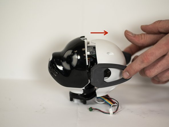

    • Remove the 4 Phillips screws to separate the head from the body.
  8. WowWee CHiP Robot Dog Ear Replacement: crwdns2935265:08crwdnd2935265:01crwdnd2935265:02crwdne2935265:0 WowWee CHiP Robot Dog Ear Replacement: crwdns2935265:08crwdnd2935265:02crwdnd2935265:02crwdne2935265:0
    • Remove the 4 Phillips screws on back of the head, and pull off the casing for the back of the head.
  9. WowWee CHiP Robot Dog Ear Replacement: crwdns2935265:09crwdnd2935265:01crwdnd2935265:03crwdne2935265:0 WowWee CHiP Robot Dog Ear Replacement: crwdns2935265:09crwdnd2935265:02crwdnd2935265:03crwdne2935265:0 WowWee CHiP Robot Dog Ear Replacement: crwdns2935265:09crwdnd2935265:03crwdnd2935265:03crwdne2935265:0
    • Unscrew the screw on the ear with a Phillips screwdriver, and pull off the plastic connector. Remove the ear from head.
