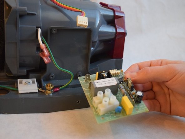

    • Begin by removing both screws and the brushed metal casing. Simply lift up at the indicated area with your hand.
    • The INSTALL and REMOVE indicators may be incorrect, so exercise caution when removing the screws.

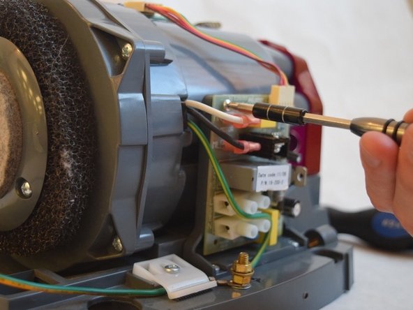

  2. World Dryer Airforce J4-973A3 Server Board Replacement: crwdns2935265:02crwdnd2935265:01crwdnd2935265:02crwdne2935265:0 World Dryer Airforce J4-973A3 Server Board Replacement: crwdns2935265:02crwdnd2935265:02crwdnd2935265:02crwdne2935265:0
    • Remove both 3/8" Ph2 screws attached to the grey belt at the top and bottom.
    • Lift the grey belt away. This gives access to the server board.

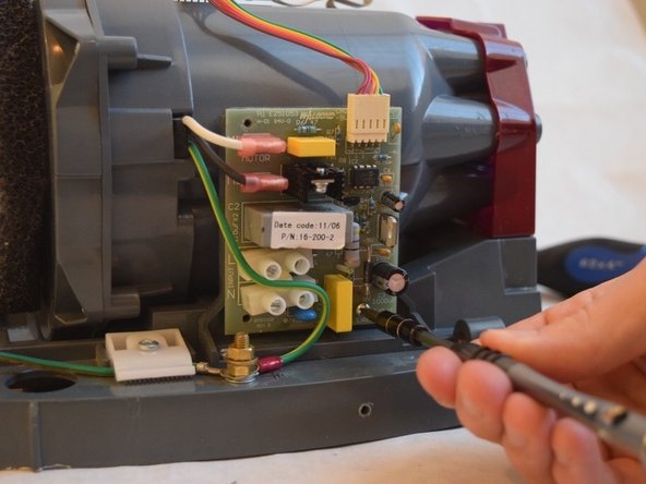

  3. World Dryer Airforce J4-973A3 Server Board Replacement: crwdns2935265:03crwdnd2935265:01crwdnd2935265:03crwdne2935265:0 World Dryer Airforce J4-973A3 Server Board Replacement: crwdns2935265:03crwdnd2935265:02crwdnd2935265:03crwdne2935265:0 World Dryer Airforce J4-973A3 Server Board Replacement: crwdns2935265:03crwdnd2935265:03crwdnd2935265:03crwdne2935265:0
    • Remove all three 1/2" Ph1 screws connecting the server board to the device.
    • During reassembly, install the screws before reattaching the wires.

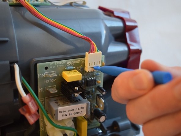

  4. World Dryer Airforce J4-973A3 Server Board Replacement: crwdns2935265:04crwdnd2935265:01crwdnd2935265:03crwdne2935265:0 World Dryer Airforce J4-973A3 Server Board Replacement: crwdns2935265:04crwdnd2935265:02crwdnd2935265:03crwdne2935265:0 World Dryer Airforce J4-973A3 Server Board Replacement: crwdns2935265:04crwdnd2935265:03crwdnd2935265:03crwdne2935265:0
    • Use a plastic opening tool to remove the two pink capped wires in the upper left corner of the server board.
    • Use the same tool to dislodge the white capped ribbon bus with the multi-colored wires.
    • After these steps, the server board should easily come off the side of the device.
