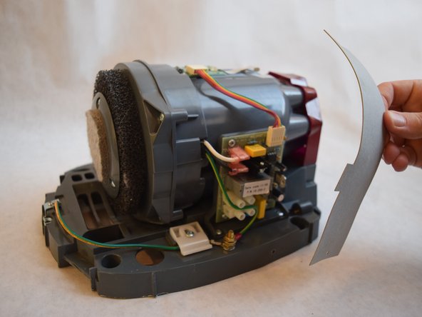

  3. World Dryer Airforce J4-973A3 Sensor Board Replacement: crwdns2935265:03crwdnd2935265:01crwdnd2935265:02crwdne2935265:0 World Dryer Airforce J4-973A3 Sensor Board Replacement: crwdns2935265:03crwdnd2935265:02crwdnd2935265:02crwdne2935265:0
    • Remove both 3/8" Ph2 screws attached to the grey belt at the top and bottom.
    • Lift the grey belt away. This gives access to the server board.

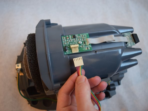

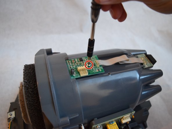

  4. World Dryer Airforce J4-973A3 Sensor Board Replacement: crwdns2935265:04crwdnd2935265:01crwdnd2935265:03crwdne2935265:0 World Dryer Airforce J4-973A3 Sensor Board Replacement: crwdns2935265:04crwdnd2935265:02crwdnd2935265:03crwdne2935265:0 World Dryer Airforce J4-973A3 Sensor Board Replacement: crwdns2935265:04crwdnd2935265:03crwdnd2935265:03crwdne2935265:0
    • Remove the rainbow ribbon cable from the middle circuit board, using a plastic opening tool.
    • Remove the 1/2" Ph1 screw from the center of the circuit board.
  5. World Dryer Airforce J4-973A3 Sensor Board Replacement: crwdns2935265:05crwdnd2935265:01crwdnd2935265:01crwdne2935265:0
    • Carefully remove the sensor board from your device.
