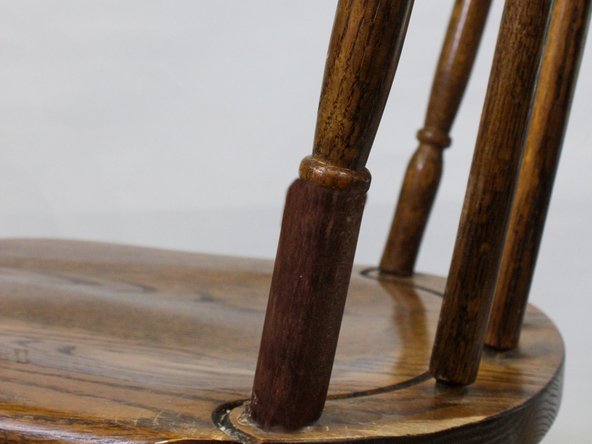

    • Saw off the broken chair slat piece(s).
  2. Wooden Chair Slat Replacement: crwdns2935265:02crwdnd2935265:01crwdnd2935265:02crwdne2935265:0 Wooden Chair Slat Replacement: crwdns2935265:02crwdnd2935265:02crwdnd2935265:02crwdne2935265:0
    • Remove the broken piece from the chair.
    • Sand down the chair where the piece was removed.
  3. Wooden Chair Slat Replacement: crwdns2935265:03crwdnd2935265:01crwdnd2935265:03crwdne2935265:0 Wooden Chair Slat Replacement: crwdns2935265:03crwdnd2935265:02crwdnd2935265:03crwdne2935265:0 Wooden Chair Slat Replacement: crwdns2935265:03crwdnd2935265:03crwdnd2935265:03crwdne2935265:0

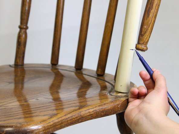

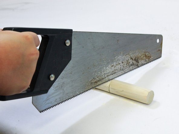

    • Measure a wooden dowl similar in size to the chair slat.
    • Mark the measurement on the wooden dowel with a marker.
    • Cut the wooden dowel directly on the marked line.

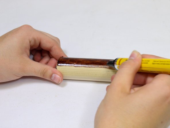

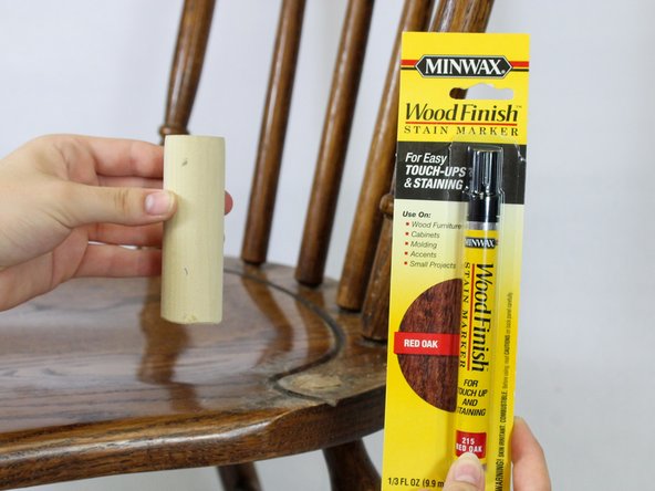

  4. Wooden Chair Slat Replacement: crwdns2935265:04crwdnd2935265:01crwdnd2935265:03crwdne2935265:0 Wooden Chair Slat Replacement: crwdns2935265:04crwdnd2935265:02crwdnd2935265:03crwdne2935265:0 Wooden Chair Slat Replacement: crwdns2935265:04crwdnd2935265:03crwdnd2935265:03crwdne2935265:0
    • Sand the sawed-off end of the dowel.
    • Apply wood stain to the dowel piece to match the chair's color.
    • Apply wood stain following the direction of the wood grain.

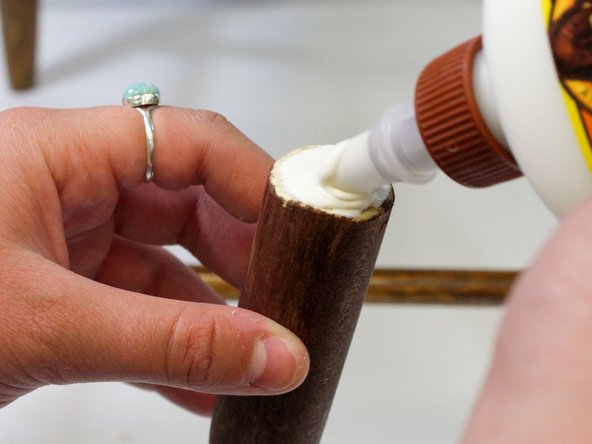

  5. Wooden Chair Slat Replacement: crwdns2935265:05crwdnd2935265:01crwdnd2935265:03crwdne2935265:0 Wooden Chair Slat Replacement: crwdns2935265:05crwdnd2935265:02crwdnd2935265:03crwdne2935265:0 Wooden Chair Slat Replacement: crwdns2935265:05crwdnd2935265:03crwdnd2935265:03crwdne2935265:0
    • Let the wood stain dry.

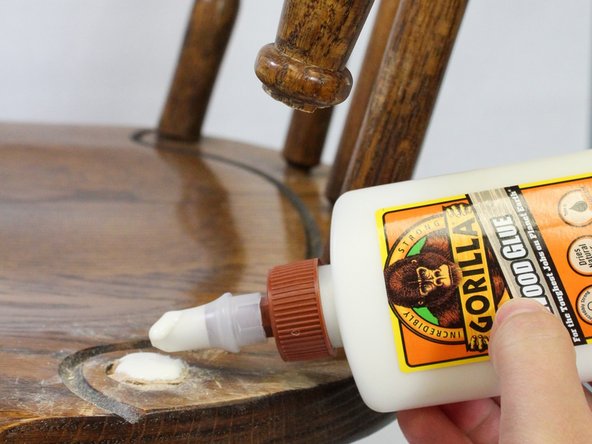

    • Add wood glue to the top of the new slat piece.
    • Add wood glue to the base of the chair.

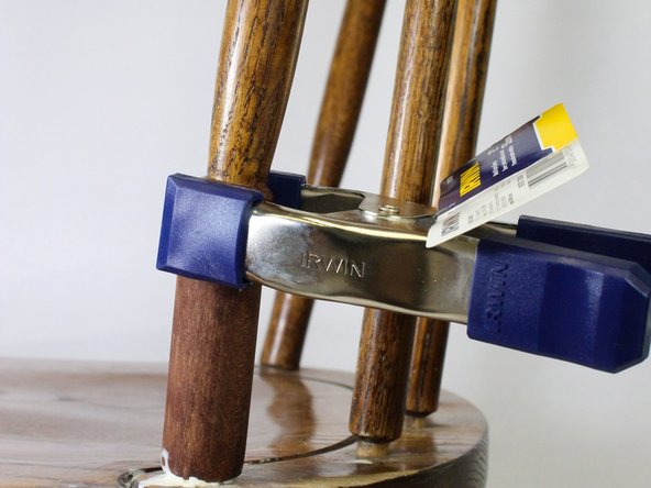

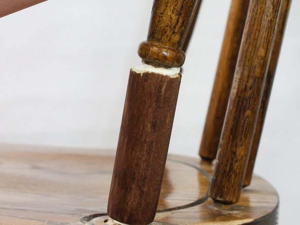

  6. Wooden Chair Slat Replacement: crwdns2935265:06crwdnd2935265:01crwdnd2935265:03crwdne2935265:0 Wooden Chair Slat Replacement: crwdns2935265:06crwdnd2935265:02crwdnd2935265:03crwdne2935265:0 Wooden Chair Slat Replacement: crwdns2935265:06crwdnd2935265:03crwdnd2935265:03crwdne2935265:0
    • Insert the new slat piece into the missing space.
    • Add the clamp to keep it in place for at least 30 minutes.
  7. Wooden Chair Slat Replacement: crwdns2935265:07crwdnd2935265:01crwdnd2935265:02crwdne2935265:0 Wooden Chair Slat Replacement: crwdns2935265:07crwdnd2935265:02crwdnd2935265:02crwdne2935265:0
    • Let the slat piece dry for at least 24 hours.
    • The chair is then ready for use.
