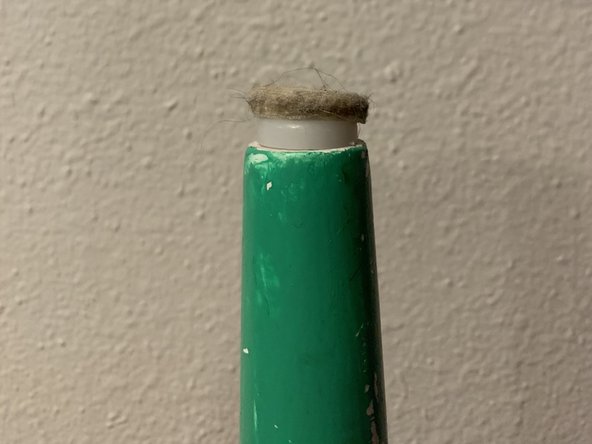

      • Turn the stool upside down so it is stable on the ground and the legs are faced up in the air.
    2. Wood Stool Leg Glide Replacement: crwdns2935265:02crwdnd2935265:01crwdnd2935265:01crwdne2935265:0
      • Clean the end of the sled gliders and the legs to remove dust and debris.
    3. Wood Stool Leg Glide Replacement: crwdns2935265:03crwdnd2935265:01crwdnd2935265:01crwdne2935265:0
      • Peel the sled glides off of the top of the screw on glides on all four of the legs.
    4. Wood Stool Leg Glide Replacement: crwdns2935265:04crwdnd2935265:01crwdnd2935265:01crwdne2935265:0
      • Use a 1.59mm drill bit and unscrew the screw from all four legs. Then remove the screw on glides.
      • Make sure the drill is faced straight up and down or the screw will become stripped.
    5. Wood Stool Leg Glide Replacement: crwdns2935265:05crwdnd2935265:01crwdnd2935265:01crwdne2935265:0
      • Pry the remaining part of the screw with a hammer if the screw is not drilled out all of the way.
    6. Wood Stool Leg Glide Replacement: crwdns2935265:06crwdnd2935265:01crwdnd2935265:01crwdne2935265:0
      • Use a 1.59mm drill bit to drill on the new screw on glides in the center of all four stool legs.
    7. Wood Stool Leg Glide Replacement: crwdns2935265:07crwdnd2935265:01crwdnd2935265:02crwdne2935265:0 Wood Stool Leg Glide Replacement: crwdns2935265:07crwdnd2935265:02crwdnd2935265:02crwdne2935265:0
      • Stick the new sled glider at the center of the screw on glides for all four legs.
