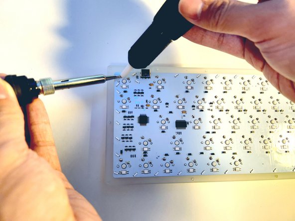

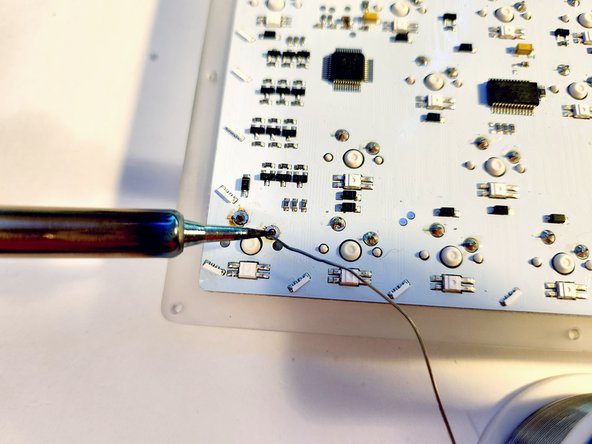

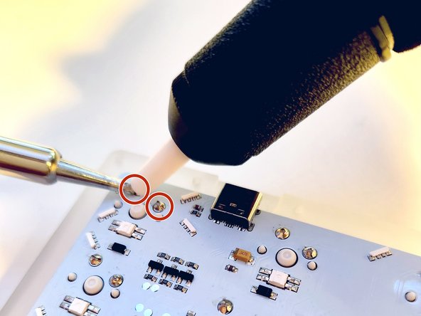

    • If you're unfamiliar with solder or need a refresher, review the How to Solder and Desolder guide.
    • Set your soldering iron to 400 °C.
    • Apply the soldering iron to the solder joints and remove the solder with the desoldering pump.
    • Be careful when soldering as the iron is very hot.

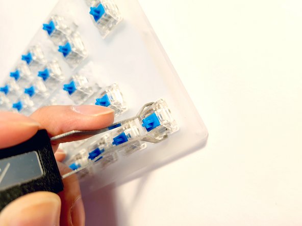

  4. Womier K66 Mechanical Keyboard Switch Replacement: crwdns2935265:04crwdnd2935265:01crwdnd2935265:03crwdne2935265:0 Womier K66 Mechanical Keyboard Switch Replacement: crwdns2935265:04crwdnd2935265:02crwdnd2935265:03crwdne2935265:0 Womier K66 Mechanical Keyboard Switch Replacement: crwdns2935265:04crwdnd2935265:03crwdnd2935265:03crwdne2935265:0

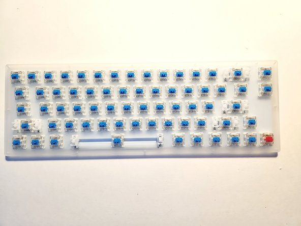

    • Remove the key switch from the board using the key switch puller.

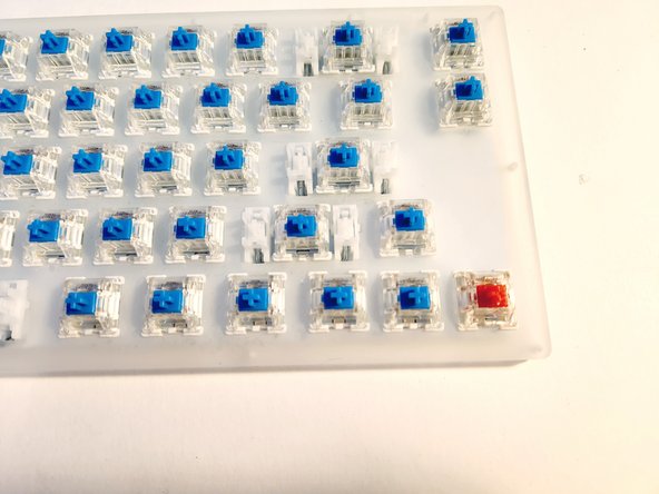

  5. Womier K66 Mechanical Keyboard Switch Replacement: crwdns2935265:05crwdnd2935265:01crwdnd2935265:03crwdne2935265:0 Womier K66 Mechanical Keyboard Switch Replacement: crwdns2935265:05crwdnd2935265:02crwdnd2935265:03crwdne2935265:0 Womier K66 Mechanical Keyboard Switch Replacement: crwdns2935265:05crwdnd2935265:03crwdnd2935265:03crwdne2935265:0
    • Place your new switch onto the board.
    • In this case we used a Gateron Linear switch but this could be any variety of switches.

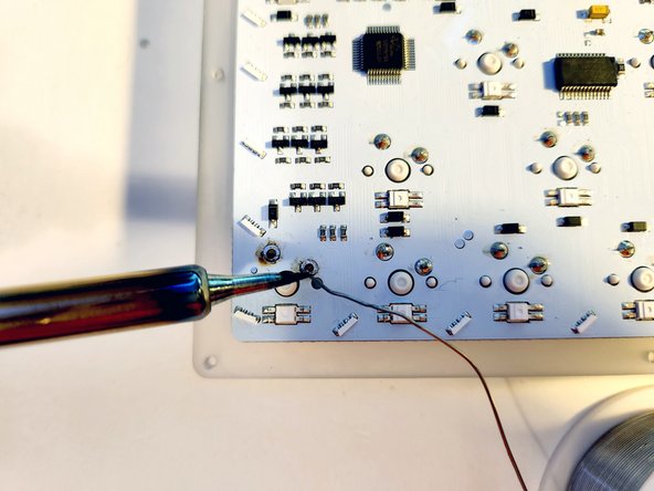

  6. Womier K66 Mechanical Keyboard Switch Replacement: crwdns2935265:06crwdnd2935265:01crwdnd2935265:03crwdne2935265:0 Womier K66 Mechanical Keyboard Switch Replacement: crwdns2935265:06crwdnd2935265:02crwdnd2935265:03crwdne2935265:0 Womier K66 Mechanical Keyboard Switch Replacement: crwdns2935265:06crwdnd2935265:03crwdnd2935265:03crwdne2935265:0
    • Apply new solder to the soldering joints of the replacement switch.
