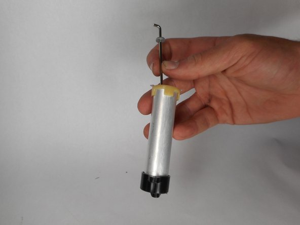

  9. Wolf Gourmet WGTR102S Slide Assist Plunger Replacement, Slide Assist Plunger: crwdns2935265:09crwdnd2935265:01crwdnd2935265:01crwdne2935265:0
    • Remove the top panel by bending the tabs on each side straight up.
  10. Wolf Gourmet WGTR102S Slide Assist Plunger Replacement: crwdns2935265:010crwdnd2935265:01crwdnd2935265:01crwdne2935265:0
    • Remove the two 8mm screws on the bottom of the plunger using a Tri-point Y1 screwdriver.
  11. Wolf Gourmet WGTR102S Slide Assist Plunger Replacement: crwdns2935265:011crwdnd2935265:01crwdnd2935265:02crwdne2935265:0 Wolf Gourmet WGTR102S Slide Assist Plunger Replacement: crwdns2935265:011crwdnd2935265:02crwdnd2935265:02crwdne2935265:0
    • Remove the plunger from the device.
