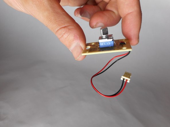

  9. Wolf Gourmet WGTR102S Heat Dial Replacement, Heat Dial: crwdns2935265:09crwdnd2935265:01crwdnd2935265:01crwdne2935265:0
    • Remove the two 4mm screws found on each side of the circuit board using a Tri-point Y1 screwdriver.
  10. Wolf Gourmet WGTR102S Heat Dial Replacement: crwdns2935265:010crwdnd2935265:01crwdnd2935265:02crwdne2935265:0 Wolf Gourmet WGTR102S Heat Dial Replacement: crwdns2935265:010crwdnd2935265:02crwdnd2935265:02crwdne2935265:0
    • Remove the circuit board from the device.
