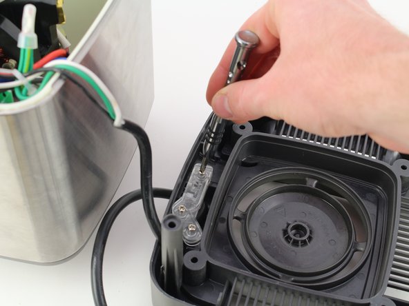

  5. Wolf Gourmet WGBL100S Power Cord Replacement: crwdns2935265:05crwdnd2935265:01crwdnd2935265:02crwdne2935265:0 Wolf Gourmet WGBL100S Power Cord Replacement: crwdns2935265:05crwdnd2935265:02crwdnd2935265:02crwdne2935265:0
    • On the underside of the base, unscrew the three 3/8" long screws on the plastic piece holding the power cord in place using a Phillips #1 screwdriver.
    • Pull the plastic cover off.

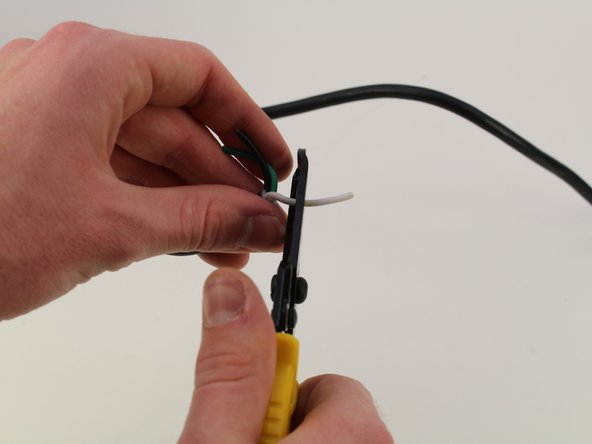

  6. Wolf Gourmet WGBL100S Power Cord Replacement: crwdns2935265:06crwdnd2935265:01crwdnd2935265:01crwdne2935265:0
    • Using a wire cutter, cut the three wires of the power cord.

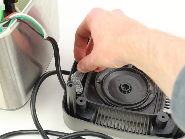

  7. Wolf Gourmet WGBL100S Power Cord Replacement: crwdns2935265:07crwdnd2935265:01crwdnd2935265:02crwdne2935265:0 Wolf Gourmet WGBL100S Power Cord Replacement: crwdns2935265:07crwdnd2935265:02crwdnd2935265:02crwdne2935265:0
    • Pull the cut power cord through the base.
    • Then thread the replacement cord back through and re-attach the plastic cover.

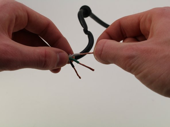

  8. Wolf Gourmet WGBL100S Power Cord Replacement: crwdns2935265:08crwdnd2935265:01crwdnd2935265:03crwdne2935265:0 Wolf Gourmet WGBL100S Power Cord Replacement: crwdns2935265:08crwdnd2935265:02crwdnd2935265:03crwdne2935265:0 Wolf Gourmet WGBL100S Power Cord Replacement: crwdns2935265:08crwdnd2935265:03crwdnd2935265:03crwdne2935265:0
    • Strip about an inch of insulation off of the snipped power cord and your replacement cord.
    • Twist each strand of wires together to keep them neat.

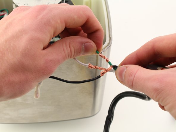

  9. Wolf Gourmet WGBL100S Power Cord Replacement: crwdns2935265:09crwdnd2935265:01crwdnd2935265:02crwdne2935265:0 Wolf Gourmet WGBL100S Power Cord Replacement: crwdns2935265:09crwdnd2935265:02crwdnd2935265:02crwdne2935265:0
    • Twist together the wires from the replacement cord to the wires still attached to the blender.
    • Solder the connection if possible.

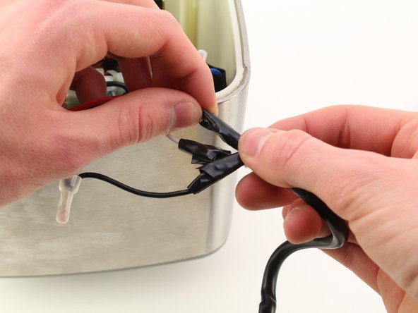

  10. Wolf Gourmet WGBL100S Power Cord Replacement: crwdns2935265:010crwdnd2935265:01crwdnd2935265:02crwdne2935265:0 Wolf Gourmet WGBL100S Power Cord Replacement: crwdns2935265:010crwdnd2935265:02crwdnd2935265:02crwdne2935265:0
    • Wrap all the connections in electrical tape or heat shrink tubing.
To reassemble your device, follow steps 1-5 in reverse order.
