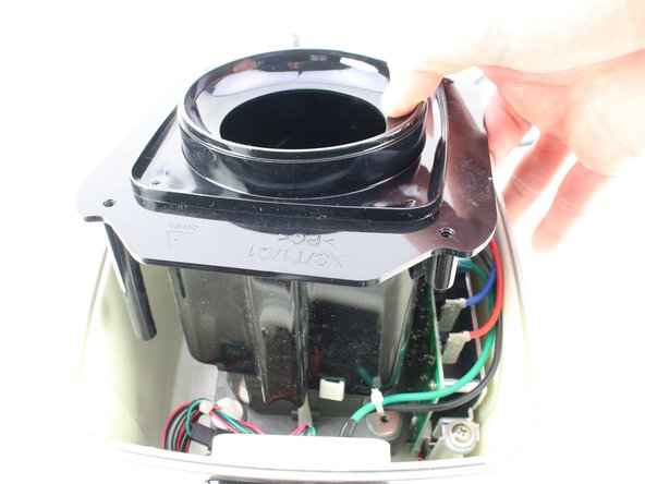

  4. Wolf Gourmet WGBL100S Control Board Replacement: crwdns2935265:04crwdnd2935265:01crwdnd2935265:02crwdne2935265:0 Wolf Gourmet WGBL100S Control Board Replacement: crwdns2935265:04crwdnd2935265:02crwdnd2935265:02crwdne2935265:0
    • Pull off the plastic housing.

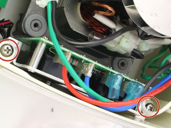

  5. Wolf Gourmet WGBL100S Control Board Replacement: crwdns2935265:05crwdnd2935265:01crwdnd2935265:02crwdne2935265:0 Wolf Gourmet WGBL100S Control Board Replacement: crwdns2935265:05crwdnd2935265:02crwdnd2935265:02crwdne2935265:0
    • Using the same Phillips #2 screwdriver, remove the two 3/4" long screws holding the control board in place.

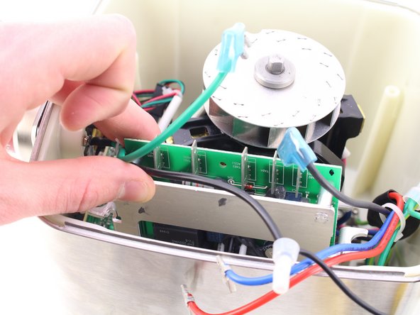

  6. Wolf Gourmet WGBL100S Control Board Replacement: crwdns2935265:06crwdnd2935265:01crwdnd2935265:02crwdne2935265:0 Wolf Gourmet WGBL100S Control Board Replacement: crwdns2935265:06crwdnd2935265:02crwdnd2935265:02crwdne2935265:0
    • Using pliers, pull off all the connectors on the top.
  7. Wolf Gourmet WGBL100S Control Board Replacement: crwdns2935265:07crwdnd2935265:01crwdnd2935265:01crwdne2935265:0
    • Pull or pry off the last connector block, then remove the control board.
