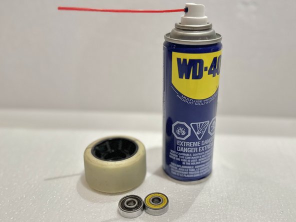

  3. Wobbly Wheel Replacement & Frame Tightening: crwdns2935265:03crwdnd2935265:01crwdnd2935265:02crwdne2935265:0 Wobbly Wheel Replacement & Frame Tightening: crwdns2935265:03crwdnd2935265:02crwdnd2935265:02crwdne2935265:0
    • Oil the bearings with WD-40 to remove any rust or dirt.
    • Make sure to oil them front and back to get rid off any unwanted sludge or corrode.
  4. Wobbly Wheel Replacement & Frame Tightening: crwdns2935265:04crwdnd2935265:01crwdnd2935265:02crwdne2935265:0 Wobbly Wheel Replacement & Frame Tightening: crwdns2935265:04crwdnd2935265:02crwdnd2935265:02crwdne2935265:0

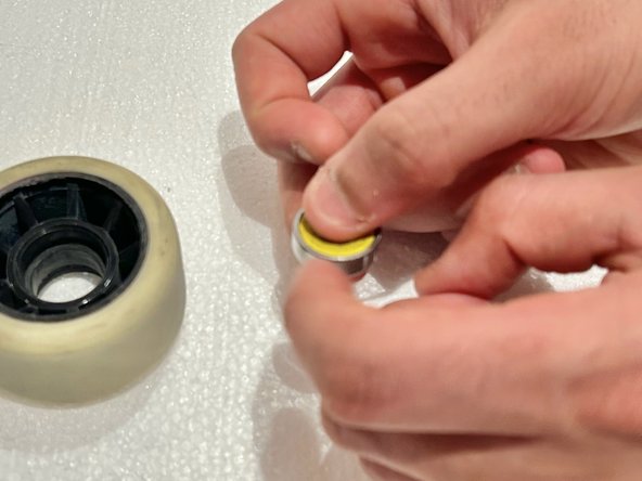

    • Make the bearings spin with your finger.
    • Clean any extra oil/debris off the bearings.
    • Ensure the bearings move/rotate freely.
  5. Wobbly Wheel Replacement & Frame Tightening: crwdns2935265:05crwdnd2935265:01crwdnd2935265:02crwdne2935265:0 Wobbly Wheel Replacement & Frame Tightening: crwdns2935265:05crwdnd2935265:02crwdnd2935265:02crwdne2935265:0
    • Put the bearings back in the new wheel.
    • Push them into the wheel firmly to ensure their proper placement.
    • Rotate the wheel to verify.
