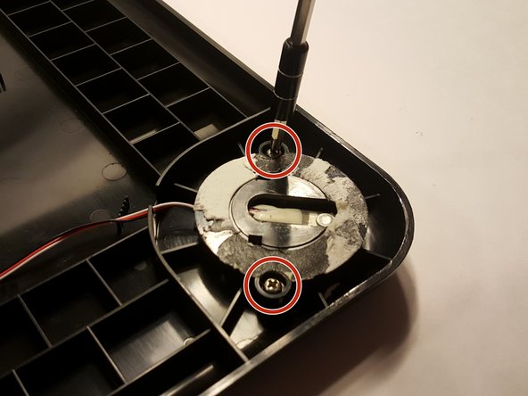

    1. Withings Smart Body Analyzer Pressure Sensor Replacement, Pressure Sensor: crwdns2935265:04crwdnd2935265:01crwdnd2935265:01crwdne2935265:0
      • Notice the red and black wires connecting the circuit board to each of the pressure sensors.
      • Using a soldering iron and de-soldering braid, remove the soldered red and black wires from the circuit board
    2. Withings Smart Body Analyzer Pressure Sensor Replacement: crwdns2935265:05crwdnd2935265:01crwdnd2935265:02crwdne2935265:0 Withings Smart Body Analyzer Pressure Sensor Replacement: crwdns2935265:05crwdnd2935265:02crwdnd2935265:02crwdne2935265:0
      • Use a Phillips-head screwdriver to remove the screw from the sensor. There will be two screws per sensor.
    3. Withings Smart Body Analyzer Pressure Sensor Replacement: crwdns2935265:06crwdnd2935265:01crwdnd2935265:02crwdne2935265:0 Withings Smart Body Analyzer Pressure Sensor Replacement: crwdns2935265:06crwdnd2935265:02crwdnd2935265:02crwdne2935265:0
      • Remove any sensors you need and you are now ready to replace or repair depending on your needs.

The issue is not the pressure sensor, but a weak area within the foot.
Having taken my scales apart to repair them I found the the foot (pictured within the plastic ring above) has a metal disc in it, that is supported by a few weak plastic ribs that easily damage. I filled them in with Araldyte to create a firm level surface and all is good again.
As a design engineer who fault-finds all day, I would say this is either poor design (an oversight), or brilliant salesmanship (a weak point that allows Withings to sell more scales). Which is true? Only they know.
