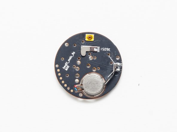

  5. Withings Activité Pop Smartwatch Teardown, Access and remove the main PCB: crwdns2935265:05crwdnd2935265:01crwdnd2935265:03crwdne2935265:0 Withings Activité Pop Smartwatch Teardown, Access and remove the main PCB: crwdns2935265:05crwdnd2935265:02crwdnd2935265:03crwdne2935265:0 Withings Activité Pop Smartwatch Teardown, Access and remove the main PCB: crwdns2935265:05crwdnd2935265:03crwdnd2935265:03crwdne2935265:0
    • Using a thin flat blade screwdriver remove 12 (!) fine threaded screws to release the main PCB from the stepper motors of three dial hands.
  6. Withings Activité Pop Smartwatch Teardown, Have a close look at the main PCB: crwdns2935265:06crwdnd2935265:01crwdnd2935265:02crwdne2935265:0 Withings Activité Pop Smartwatch Teardown, Have a close look at the main PCB: crwdns2935265:06crwdnd2935265:02crwdnd2935265:02crwdne2935265:0
    • ...and enjoy the view.

    • This Withings Activité Pop Smartwatch had water ingress and it failed due to corrosion. A common fault with this watch is loose inner screws, leading to poor PCB contact with motors. When you change battery make sure you apply silicone grease on the rubber gasket of the case back. The dial and hands are not accessible since the glass is pressed.
