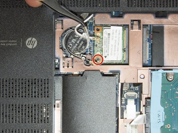

    1. Wireless card replacement, Disconnect the antenna cables & unfasten the screw: crwdns2935265:05crwdnd2935265:01crwdnd2935265:03crwdne2935265:0 Wireless card replacement, Disconnect the antenna cables & unfasten the screw: crwdns2935265:05crwdnd2935265:02crwdnd2935265:03crwdne2935265:0 Wireless card replacement, Disconnect the antenna cables & unfasten the screw: crwdns2935265:05crwdnd2935265:03crwdnd2935265:03crwdne2935265:0

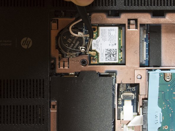

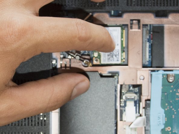

    2. Wireless card replacement, Substitute the wireless card: crwdns2935265:06crwdnd2935265:01crwdnd2935265:03crwdne2935265:0 Wireless card replacement, Substitute the wireless card: crwdns2935265:06crwdnd2935265:02crwdnd2935265:03crwdne2935265:0 Wireless card replacement, Substitute the wireless card: crwdns2935265:06crwdnd2935265:03crwdnd2935265:03crwdne2935265:0
      • Grab the standard wireless card as it is shown in the first picture and gently pull it away at the tilt angle.
      • Place the M2.0×2.5 screw in the hole of the new wifi module, tilt it, and gently insert it in its slot. Then press the wireless card down with a hand and fasten the screw using a PH #00 with the other one.
      • Using the tweezers center and hold the connectors of the antenna cables over their terminals and then press them straight down gently using your finger. Cable 1 goes with the Main terminal and Cable 2 with the Aux terminal.
