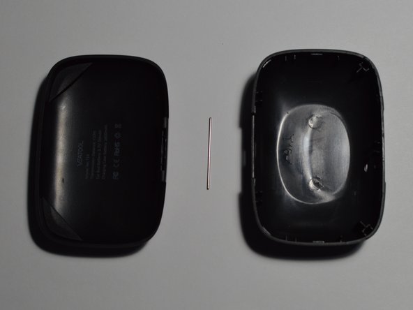

  2. Wireless Earbuds BMANI-VEAT00L Teardown, Case Disassembly: crwdns2935265:02crwdnd2935265:01crwdnd2935265:03crwdne2935265:0 Wireless Earbuds BMANI-VEAT00L Teardown, Case Disassembly: crwdns2935265:02crwdnd2935265:02crwdnd2935265:03crwdne2935265:0 Wireless Earbuds BMANI-VEAT00L Teardown, Case Disassembly: crwdns2935265:02crwdnd2935265:03crwdnd2935265:03crwdne2935265:0
    • Case shell is mounted to earbud holder with plastic clips
    • 4 plastic clips need to be released

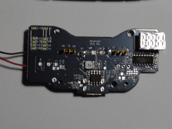

  5. Wireless Earbuds BMANI-VEAT00L Teardown, Case Dissembled: crwdns2935265:05crwdnd2935265:01crwdnd2935265:02crwdne2935265:0 Wireless Earbuds BMANI-VEAT00L Teardown, Case Dissembled: crwdns2935265:05crwdnd2935265:02crwdnd2935265:02crwdne2935265:0
    • All parts of case disassembled and detailed view of PCB.

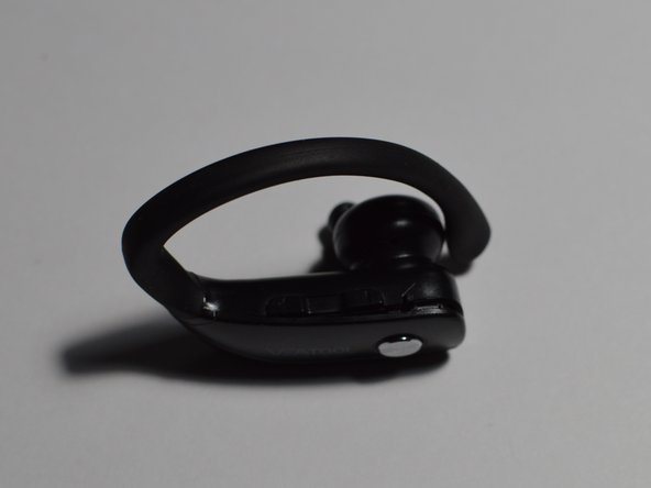

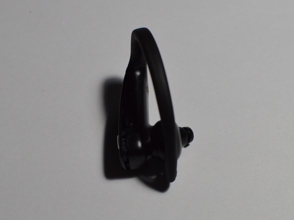

  6. Wireless Earbuds BMANI-VEAT00L Teardown, Earbud Overview: crwdns2935265:06crwdnd2935265:01crwdnd2935265:03crwdne2935265:0 Wireless Earbuds BMANI-VEAT00L Teardown, Earbud Overview: crwdns2935265:06crwdnd2935265:02crwdnd2935265:03crwdne2935265:0 Wireless Earbuds BMANI-VEAT00L Teardown, Earbud Overview: crwdns2935265:06crwdnd2935265:03crwdnd2935265:03crwdne2935265:0
    • Assembled ear bud

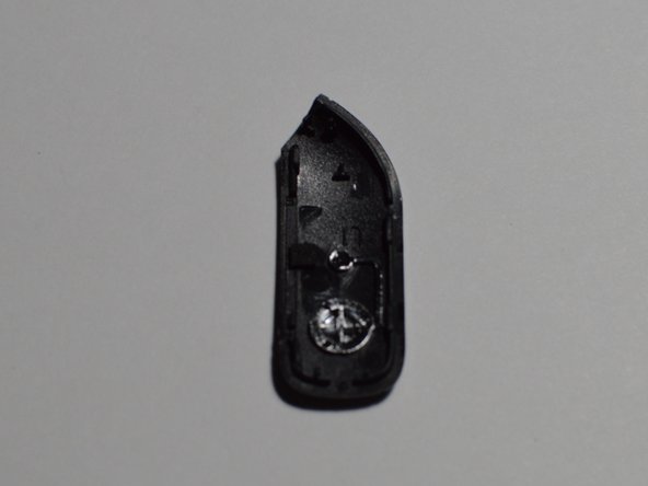

  8. Wireless Earbuds BMANI-VEAT00L Teardown, Electronics of Earbud: crwdns2935265:08crwdnd2935265:01crwdnd2935265:01crwdne2935265:0
    • PCB can be lifted out of earbud. The speaker section is sealed in the end of the earbud.

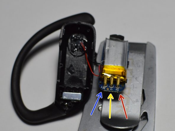

  10. Wireless Earbuds BMANI-VEAT00L Teardown, Connections: crwdns2935265:010crwdnd2935265:01crwdnd2935265:03crwdne2935265:0 Wireless Earbuds BMANI-VEAT00L Teardown, Connections: crwdns2935265:010crwdnd2935265:02crwdnd2935265:03crwdne2935265:0 Wireless Earbuds BMANI-VEAT00L Teardown, Connections: crwdns2935265:010crwdnd2935265:03crwdnd2935265:03crwdne2935265:0
    • How the earbuds connect to the case to charge.
    • 5V
    • GND
    • DET
    • Case PCB has spring load pins on it
