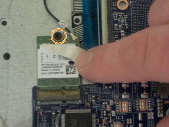

  5. Wireless Card  Replacement, Wireless Card: crwdns2935265:05crwdnd2935265:01crwdnd2935265:02crwdne2935265:0 Wireless Card  Replacement, Wireless Card: crwdns2935265:05crwdnd2935265:02crwdnd2935265:02crwdne2935265:0
    • Locate the wireless card in the center of the computer and attached to the motherboard.
    • Locate the 4.0 mm hidden screw holding the wireless card and gently remove it.
  6. Wireless Card  Replacement: crwdns2935265:06crwdnd2935265:01crwdnd2935265:02crwdne2935265:0 Wireless Card  Replacement: crwdns2935265:06crwdnd2935265:02crwdnd2935265:02crwdne2935265:0
    • Remove the old wireless card and replace with the new wireless card. Gently screw it into place.
    • Be sure to keep the replacement within the package until you are ready to place it.
