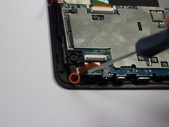

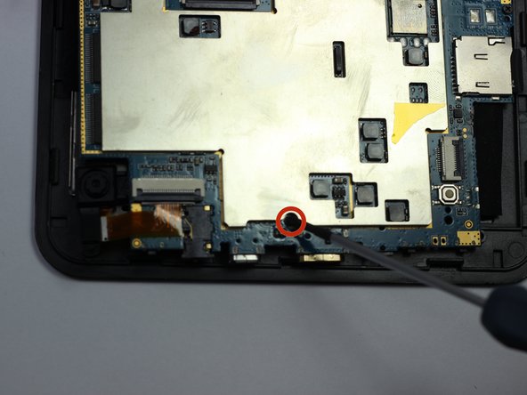

  6. Wintec Filemate Clear 7" Motherboard Replacement, Motherboard: crwdns2935265:06crwdnd2935265:01crwdnd2935265:01crwdne2935265:0
    • Locate each of the motherboard's 4 mm screws.
  7. Wintec Filemate Clear 7" Motherboard Replacement, Unscrewing Everything: crwdns2935265:07crwdnd2935265:01crwdnd2935265:03crwdne2935265:0 Wintec Filemate Clear 7" Motherboard Replacement, Unscrewing Everything: crwdns2935265:07crwdnd2935265:02crwdnd2935265:03crwdne2935265:0 Wintec Filemate Clear 7" Motherboard Replacement, Unscrewing Everything: crwdns2935265:07crwdnd2935265:03crwdnd2935265:03crwdne2935265:0
    • Remove each of the four 4 mm screws from the motherboard pictured to the left.
    • Use a Phillips #00 precision screwdriver.

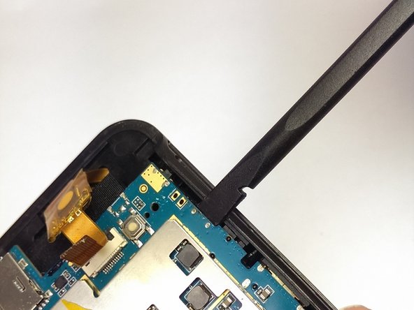

  8. Wintec Filemate Clear 7" Motherboard Replacement, Detach the Motherboard: crwdns2935265:08crwdnd2935265:01crwdnd2935265:02crwdne2935265:0 Wintec Filemate Clear 7" Motherboard Replacement, Detach the Motherboard: crwdns2935265:08crwdnd2935265:02crwdnd2935265:02crwdne2935265:0
    • Use the spudger to pry the instrument array from its plastic housing.
