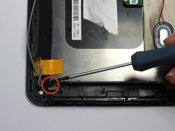

    • Locate the four corners of the backplate.
  2. Wintec Filemate Clear 7" Front Screen Replacement: crwdns2935265:02crwdnd2935265:01crwdnd2935265:02crwdne2935265:0 Wintec Filemate Clear 7" Front Screen Replacement: crwdns2935265:02crwdnd2935265:02crwdnd2935265:02crwdne2935265:0
    • Pry off the backplate by inserting a spudger or plastic opening tool into each corner and popping them open.
