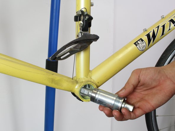

  13. Windsor Willow Bottom Bracket Replacement, Bottom Bracket: crwdns2935265:013crwdnd2935265:01crwdnd2935265:01crwdne2935265:0
    • The Bottom Bracket is located at the bottom of the frame, directly underneath the saddle.
  14. Windsor Willow Bottom Bracket Replacement: crwdns2935265:014crwdnd2935265:01crwdnd2935265:02crwdne2935265:0 Windsor Willow Bottom Bracket Replacement: crwdns2935265:014crwdnd2935265:02crwdnd2935265:02crwdne2935265:0
    • On the non-drive side, insert the bottom bracket removal tool into the splines on the inside of the bottom bracket mounting ring.
    • Fit the crescent wrench onto the bottom bracket removal tool.
    • Use the crescent wrench to turn the mounting ring counterclockwise until it is loose enough to turn by hand.
  15. Windsor Willow Bottom Bracket Replacement: crwdns2935265:015crwdnd2935265:01crwdnd2935265:02crwdne2935265:0 Windsor Willow Bottom Bracket Replacement: crwdns2935265:015crwdnd2935265:02crwdnd2935265:02crwdne2935265:0
    • Turn the bottom bracket removal tool counterclockwise by hand until the mounting ring is free of the bicycle frame
  16. Windsor Willow Bottom Bracket Replacement: crwdns2935265:016crwdnd2935265:01crwdnd2935265:03crwdne2935265:0 Windsor Willow Bottom Bracket Replacement: crwdns2935265:016crwdnd2935265:02crwdnd2935265:03crwdne2935265:0 Windsor Willow Bottom Bracket Replacement: crwdns2935265:016crwdnd2935265:03crwdnd2935265:03crwdne2935265:0
    • Fit the bottom bracket removal tool into the splines on the drive-side of the bottom bracket.
    • Use the crescent wrench to turn the bottom bracket removal tool clockwise until the bottom bracket is loose enough to turn by hand.
  17. Windsor Willow Bottom Bracket Replacement: crwdns2935265:017crwdnd2935265:01crwdnd2935265:02crwdne2935265:0 Windsor Willow Bottom Bracket Replacement: crwdns2935265:017crwdnd2935265:02crwdnd2935265:02crwdne2935265:0
    • Turn the bottom bracket removal tool clockwise by hand until its threads are no longer in contact with those of the frame.
    • Pull the bottom bracket out of the bike frame.
To reassemble your device, follow these instructions in reverse order, keeping in mind that the drive-side threads are reverse threads, meaning counterclockwise turning tightens the piece and clockwise turning loosens the piece.
