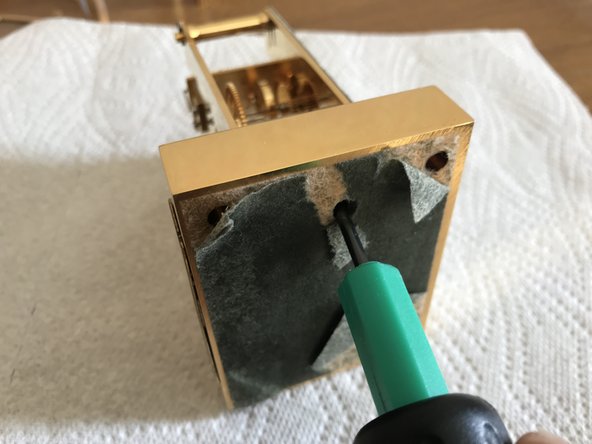

  3. Wind-up carriage clock Service clean, Loosening the base screws: crwdns2935265:03crwdnd2935265:01crwdnd2935265:02crwdne2935265:0 Wind-up carriage clock Service clean, Loosening the base screws: crwdns2935265:03crwdnd2935265:02crwdnd2935265:02crwdne2935265:0
    • Before starting disassembly it's a good idea to wrap a length of sticky tape around the front and two sides of the clock towards the bottom, from one rear pillar to the other, to prevent the front and side glasses falling out as you remove the case.
    • Turn the clock over and peal back the felt covering the base at each corner, to reveal the holes for the screws holding the four brass case pillars to the base.
    • With a suitable screwdriver, loosen all four screws just a little. They may initially be fairly tight. Do not let the screwdriver slip in the screw heads. Do not remove the screws just yet.

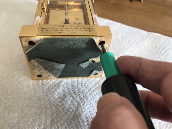

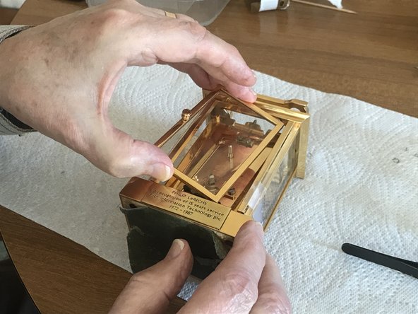

  4. Wind-up carriage clock Service clean, Removing the read door: crwdns2935265:04crwdnd2935265:01crwdnd2935265:02crwdne2935265:0 Wind-up carriage clock Service clean, Removing the read door: crwdns2935265:04crwdnd2935265:02crwdnd2935265:02crwdne2935265:0
    • Loosen the screws until you can separate the case from the base by just a few millimetres. You should then be able to remove the back door.
    • The back door has a pin in the top engaging with the top of the clock and a pin in the bottom engaging with the base. These are liable to fall out and get lost. Stow them somewhere safe.
  5. Wind-up carriage clock Service clean, Removing the case: crwdns2935265:05crwdnd2935265:01crwdnd2935265:01crwdne2935265:0
    • The three glass panels fit into slots in the vertical pillars. Despite the tape you applied in the previous step, there is some risk they may fall out as you release the case from the base. If so, they may crack or get chipped. Replacement glass panels with their bevelled edges might be hard to source.
    • With the clock on its face and if possible, holding the case to ensure that the vertical pillars hold the glass panels, remove all four screws in the base and remove the base.
    • Check to see whether any of the glass panels is now loose and at risk of falling out. If so, carefully remove it and put it aside. Put the case aside standing upright, so that at worst, the glass panels can only slip down in their grooves until they are resting on the table.
    • If any of the glass panels come out you may well find thin plastic strips in the grooves to take up any slack and so that the glass doesn't bear directly on the brass of the pillars. Take care not to lose these strips.
    • On reassembly, if any of the glass panels and their plastic strips came out, ensure that the strips are at the far ends of the grooves from the base otherwise you may not be able to get all the screws in the base to engage with the threaded holes in the pillars.

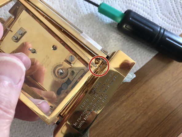

  6. Wind-up carriage clock Service clean, Detaching the movement from the base: crwdns2935265:06crwdnd2935265:01crwdnd2935265:03crwdne2935265:0 Wind-up carriage clock Service clean, Detaching the movement from the base: crwdns2935265:06crwdnd2935265:02crwdnd2935265:03crwdne2935265:0 Wind-up carriage clock Service clean, Detaching the movement from the base: crwdns2935265:06crwdnd2935265:03crwdnd2935265:03crwdne2935265:0
    • The movement is now no longer protected by the case. The escapement platform at the top is delicate. Take care not to knock it. If you like, you can skip ahead to the next step to remove it and put it somewhere safe before continuing with this step.
    • Examining the two horizontal pillars at the base of the clock which connect the front and back plates, you will see that each has a threaded hole for a screw to clamp the movement to the base.
    • Noting where those screws are, peel back the felt on the base further to reveal the screw holes.
    • Remove the two screws and put the base aside.

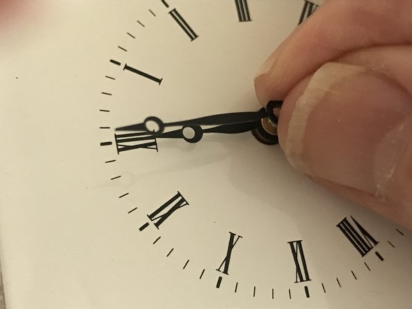

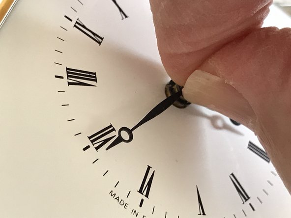

  7. Wind-up carriage clock Service clean, Removing the hands: crwdns2935265:07crwdnd2935265:01crwdnd2935265:02crwdne2935265:0 Wind-up carriage clock Service clean, Removing the hands: crwdns2935265:07crwdnd2935265:02crwdnd2935265:02crwdne2935265:0
    • The hour and minute hands are simply a push-fit on the concentric spindles that turn them.
    • Grip the minute hand either side of the spindle, between your thumbnail and a fingernail, and pull it off.
    • In the same way, remove the hour hand.
    • When you come to replacing the hands you can simply push them back on, the hour hand first. Make sure they are both accurately aligned on the 12 so that the hour hand will point directly to an hour every time the minute hand passes 12.

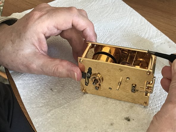

  11. Wind-up carriage clock Service clean, Removing the back plate: crwdns2935265:011crwdnd2935265:01crwdnd2935265:02crwdne2935265:0 Wind-up carriage clock Service clean, Removing the back plate: crwdns2935265:011crwdnd2935265:02crwdnd2935265:02crwdne2935265:0
    • Gently and progressively lift the back plate off the pillars joining it to the front plate. As you do so the pivots of the gear train will be released from the pivot holes in the rear panel.
    • As you lift off the rear plate some of the gears of the gear train may lift out of their pivot holes in the front panel. If so, gently remove them and reinsert them temporarily in their pivot holes in the front plate.

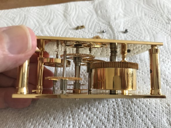

    • You will now have a forest of arbors. Take a photo of the gear train with the rear plate removed, or maybe several from different angles. This will be greatly helpful on reassembly.
  12. Wind-up carriage clock Service clean, Removing the gear train: crwdns2935265:012crwdnd2935265:01crwdnd2935265:03crwdne2935265:0 Wind-up carriage clock Service clean, Removing the gear train: crwdns2935265:012crwdnd2935265:02crwdnd2935265:03crwdne2935265:0 Wind-up carriage clock Service clean, Removing the gear train: crwdns2935265:012crwdnd2935265:03crwdnd2935265:03crwdne2935265:0
    • Some of the wheels will be blocked from being removed by others. Starting with one which is not blocked at all, lift them all off in turn and put them aside in order of removal. Take another photo after removing each one.
    • Finally, remove the drum containing the main spring.
    • Two more wheels remain, secured to the front plate by a screw. These form the reduction gear between the minute and hour hands. Remove the retaining screw and lift the wheels off.

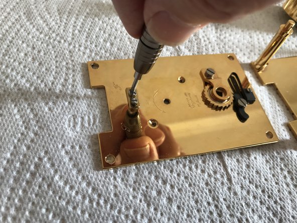

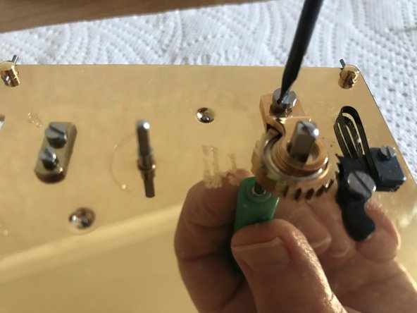

    • On the back of the back plate you will see a small piece of brass with two screws in it. One of these, covering the contrate wheel pivot hole, is an end float adjustment for the contrate wheel. Do not adjust this. The other attaches it to the back plate. Remove this screw and put the brass piece aside.

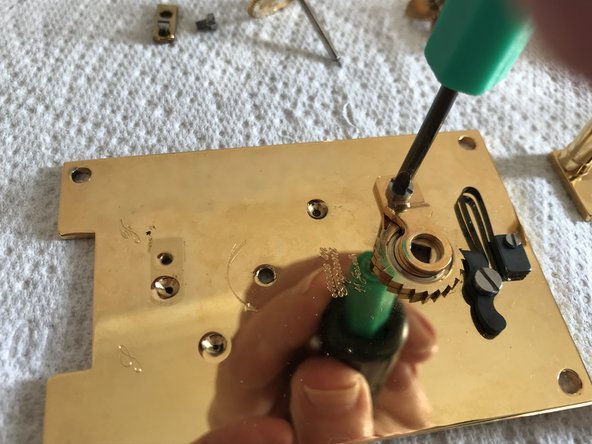

    • Another brass piece secured with a screw covers the ratchet wheel. REmove this too.
    • The clock is now fully disassembled. Take another photo of all the bits so that tomorrow you can brag to all your friends about how you got it all back together again!

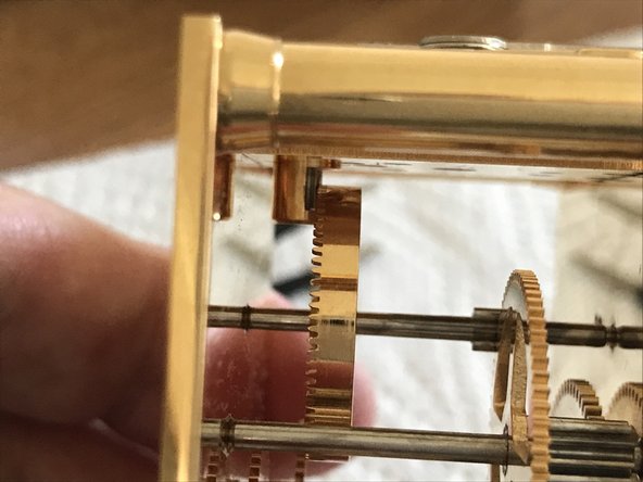

  16. Wind-up carriage clock Service clean, Checking the contrate wheel end float: crwdns2935265:017crwdnd2935265:01crwdnd2935265:02crwdne2935265:0 Wind-up carriage clock Service clean, Checking the contrate wheel end float: crwdns2935265:017crwdnd2935265:02crwdnd2935265:02crwdne2935265:0
    • For all the other arbors it doesn't matter if there's a little play allowing them to move back and forth by a tiny amount between the front and back plates as the wheels will still engage with the pinions. But not for the contrate wheel as this would alter the depth of engagement with the pinion on the escapement platform.
    • Replace the small brass piece covering the contrate wheel pivot hole. Adjust the screw over the pivot hole by the tiniest amount, first of all anticlockwise, until there is the least perceptible play. Check that the contrate wheel still turns completely freely.
    • You can wind the main spring by a minimal amount to check that the contrate wheel turns freely. Unwind it once you are satisfied.
    • Also, replace the ratchet (make sure it's the right way up) and its retaining brass piece, engaging it with the ratchet spring.
