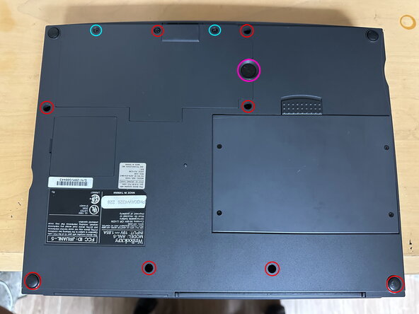

  1. WinBook XP5 Motherboard Replacement, Bottom Case Screws: crwdns2935265:01crwdnd2935265:01crwdnd2935265:01crwdne2935265:0
    • Remove the 8 large case screws, which are circled red. Two of them are hidden under the rear rubber feet. Also remove the two smaller screws, which are on the CPU and memory access door.
    • Remove the single coin screw that secures the hard drive in place.
    • Remove the main battery by pulling the release latch and levering it out, starting at the latch side. You may need to use a pry tool to do this.
