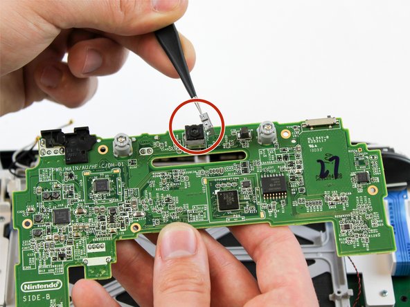

  19. Wii U GamePad Camera Replacement, Camera: crwdns2935265:019crwdnd2935265:01crwdnd2935265:02crwdne2935265:0 Wii U GamePad Camera Replacement, Camera: crwdns2935265:019crwdnd2935265:02crwdnd2935265:02crwdne2935265:0
    • Flip motherboard over.
    • Remove the metal housing around the camera with tweezers.
  20. Wii U GamePad Camera Replacement: crwdns2935265:020crwdnd2935265:01crwdnd2935265:01crwdne2935265:0
    • Pull the camera out using the tweezers.
