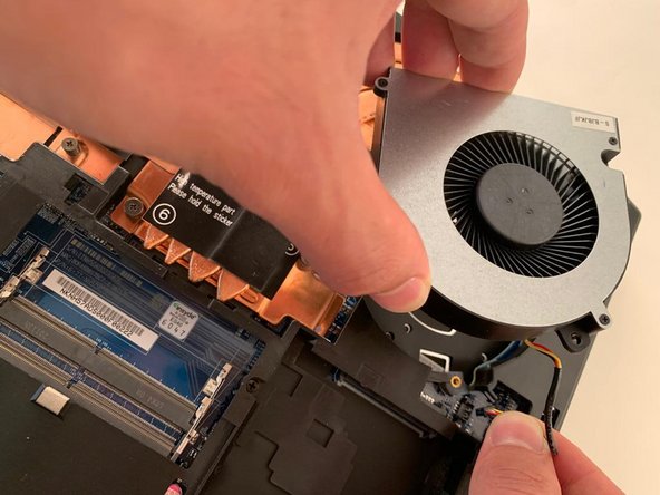

  4. Why! NH57ADS CPU Replacement, Fan: crwdns2935265:04crwdnd2935265:01crwdnd2935265:03crwdne2935265:0 Why! NH57ADS CPU Replacement, Fan: crwdns2935265:04crwdnd2935265:02crwdnd2935265:03crwdne2935265:0 Why! NH57ADS CPU Replacement, Fan: crwdns2935265:04crwdnd2935265:03crwdnd2935265:03crwdne2935265:0
    • Remove the three Phillips screws securing the fan on the right.
    • Carefully unplug the fan's power connector.
    • Remove the first fan.

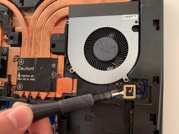

  5. Why! NH57ADS CPU Replacement, Fan and Heatsink Assembly: crwdns2935265:05crwdnd2935265:01crwdnd2935265:03crwdne2935265:0 Why! NH57ADS CPU Replacement, Fan and Heatsink Assembly: crwdns2935265:05crwdnd2935265:02crwdnd2935265:03crwdne2935265:0 Why! NH57ADS CPU Replacement, Fan and Heatsink Assembly: crwdns2935265:05crwdnd2935265:03crwdnd2935265:03crwdne2935265:0
    • Remove the two Phillips screws securing the left hand fan.
    • Remove the six Phillips heatsink retaining screws .
    • Using the two black tabs as handles, lift and remove the heatsink.

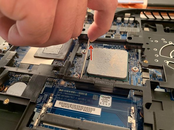

  6. Why! NH57ADS CPU Replacement, CPU: crwdns2935265:06crwdnd2935265:01crwdnd2935265:03crwdne2935265:0 Why! NH57ADS CPU Replacement, CPU: crwdns2935265:06crwdnd2935265:02crwdnd2935265:03crwdne2935265:0 Why! NH57ADS CPU Replacement, CPU: crwdns2935265:06crwdnd2935265:03crwdnd2935265:03crwdne2935265:0
    • Carefully pull the metal bar away from the processor to free it from under the retaining tab, then lift it to release the processor pins.

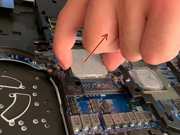

    • Gently remove the processor by lifting it straight up.
To reassemble your device, follow the instructions in reverse order.
