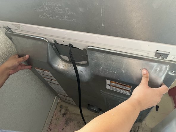

    • Unscrew the backplate by rotating each screw counterclockwise with a ratchet and 8mm socket.
    • The screws are located around the edges of the backplate.
    • The backplate is a heavy object. Hold the backplate while removing the screws or get assistance. Dropping the backplate can cause injury or break the gas pipe.
  3. Whirlpool WGD4800XQ Thermal Fuse Replacement: crwdns2935265:03crwdnd2935265:01crwdnd2935265:01crwdne2935265:0
    • Lift the backplate off of the dryer.

    • Put the back plate on the dryer.
    • If possible, have someone hold it up to align all the holes on the backplate and dryer while you use the ratchet and 8 mm socket to replace the screws.
