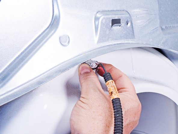

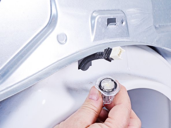

  13. Whirlpool WED87HED Dryer Drum Light Replacement, Remove the drum light: crwdns2935265:013crwdnd2935265:01crwdnd2935265:03crwdne2935265:0 Whirlpool WED87HED Dryer Drum Light Replacement, Remove the drum light: crwdns2935265:013crwdnd2935265:02crwdnd2935265:03crwdne2935265:0 Whirlpool WED87HED Dryer Drum Light Replacement, Remove the drum light: crwdns2935265:013crwdnd2935265:03crwdnd2935265:03crwdne2935265:0
    • Release the drum light module by pressing in on the tabs on the side of the module
    • Push the module through the mounting hole in the front bulkhead and into the drum.
    • Feed the wiring harness through the mounting hole and remove the module and harness from the dryer.
