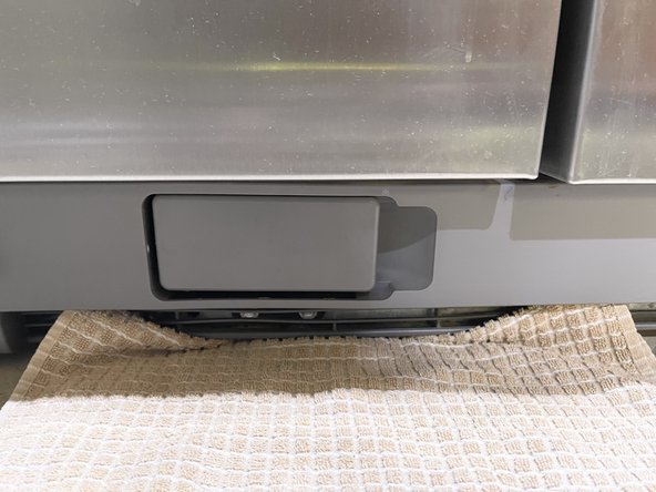

    1. Whirlpool Refrigerator Water Filter Replacement, Water Filter: crwdns2935265:02crwdnd2935265:01crwdnd2935265:03crwdne2935265:0 Whirlpool Refrigerator Water Filter Replacement, Water Filter: crwdns2935265:02crwdnd2935265:02crwdnd2935265:03crwdne2935265:0 Whirlpool Refrigerator Water Filter Replacement, Water Filter: crwdns2935265:02crwdnd2935265:03crwdnd2935265:03crwdne2935265:0
      • Pull the water filter door in the base grill open.

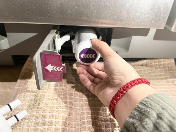

    2. Whirlpool Refrigerator Water Filter Replacement: crwdns2935265:03crwdnd2935265:01crwdnd2935265:03crwdne2935265:0 Whirlpool Refrigerator Water Filter Replacement: crwdns2935265:03crwdnd2935265:02crwdnd2935265:03crwdne2935265:0 Whirlpool Refrigerator Water Filter Replacement: crwdns2935265:03crwdnd2935265:03crwdnd2935265:03crwdne2935265:0
      • As the door opens, the filter gets ejected out.
      • When the filter is fully ejected, pull the filter out.
      • A towel is suggested as water might spill while pulling the old filter out.

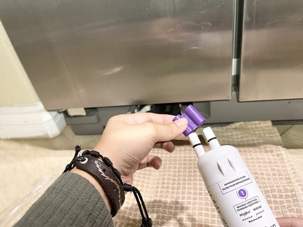

    3. Whirlpool Refrigerator Water Filter Replacement: crwdns2935265:04crwdnd2935265:01crwdnd2935265:02crwdne2935265:0 Whirlpool Refrigerator Water Filter Replacement: crwdns2935265:04crwdnd2935265:02crwdnd2935265:02crwdne2935265:0
      • Get the new filter out of its packaging.
      • Remove the covers from the filter inlets. Make sure the O-rings stay on the filter.

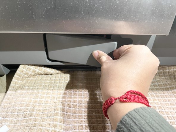

    5. Whirlpool Refrigerator Water Filter Replacement: crwdns2935265:06crwdnd2935265:01crwdnd2935265:03crwdne2935265:0 Whirlpool Refrigerator Water Filter Replacement: crwdns2935265:06crwdnd2935265:02crwdnd2935265:03crwdne2935265:0 Whirlpool Refrigerator Water Filter Replacement: crwdns2935265:06crwdnd2935265:03crwdnd2935265:03crwdne2935265:0
      • Close the filter cover door completely to snap the filter into to place correctly. You will hear a snap!

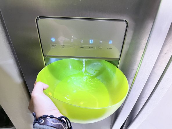

    6. Whirlpool Refrigerator Water Filter Replacement, Flush the water system: crwdns2935265:07crwdnd2935265:01crwdnd2935265:02crwdne2935265:0 Whirlpool Refrigerator Water Filter Replacement, Flush the water system: crwdns2935265:07crwdnd2935265:02crwdnd2935265:02crwdne2935265:0
      • Flush the water system by holding the water dispenser for 5 seconds and releasing for 5 seconds repeating this step until water begins to flow.
      • After water flowing, get at least a total of 3 gallons dispensed in order to see full flushed water results.

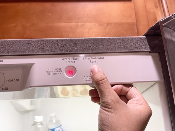

    7. Whirlpool Refrigerator Water Filter Replacement: crwdns2935265:08crwdnd2935265:01crwdnd2935265:03crwdne2935265:0 Whirlpool Refrigerator Water Filter Replacement: crwdns2935265:08crwdnd2935265:02crwdnd2935265:03crwdne2935265:0 Whirlpool Refrigerator Water Filter Replacement: crwdns2935265:08crwdnd2935265:03crwdnd2935265:03crwdne2935265:0
      • You may need to reset the filter indicator by pushing the switch 5 times in a row.
      • When the filter indicator is reset, the light should change from red to green.

Changed filter but now water is not coming out of the dispenser. Installed filter correctly per pictures. What could be the problem?
SewFrau58 - crwdns2934203:0crwdne2934203:0 crwdns2950251:0crwdne2950251:0
You will have air in the system after changing the filter. Make sure you did turn the water on. Run the water dispenser until water pushes the air out. Run the water until it clears.
