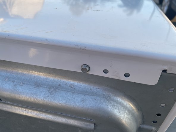

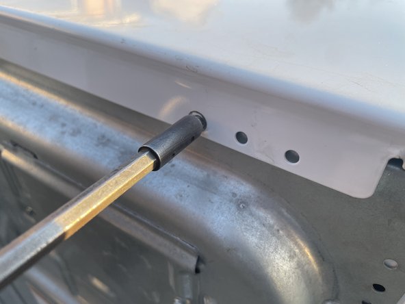

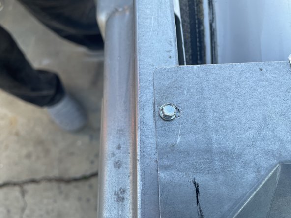

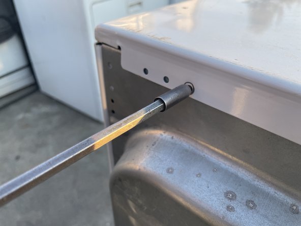

    • Before attempting this repair, it is crucial to unplug your dryer to prevent electric shock.
    • Use a T5 Torx screwdriver to remove two 6.3 mm screws. from the top back of the dryer.

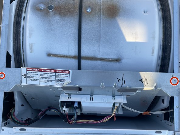

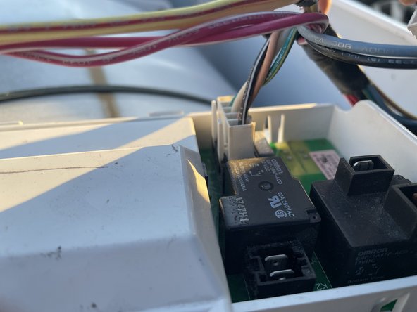

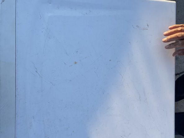

    • Slide the top of the dryer off to access the internal components.
    • Use a T5 Torx screwdriver to remove two 6.3mm screws.
    • The circuit board is mounted on a metal rack..

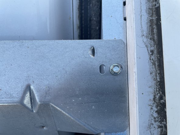

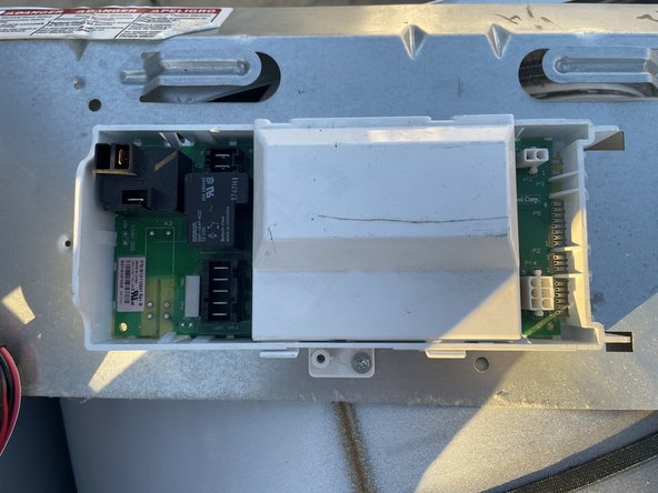

  3. Whirlpool Duet Dryer WED9200SQ1 Main Board Replacement: crwdns2935265:03crwdnd2935265:01crwdnd2935265:03crwdne2935265:0 Whirlpool Duet Dryer WED9200SQ1 Main Board Replacement: crwdns2935265:03crwdnd2935265:02crwdnd2935265:03crwdne2935265:0 Whirlpool Duet Dryer WED9200SQ1 Main Board Replacement: crwdns2935265:03crwdnd2935265:03crwdnd2935265:03crwdne2935265:0
    • Use a T5 Torx screwdriver to remove the 6.3 mm screws on both ends of the metal shelve.
    • Slide the metal shelve out to access the main board.

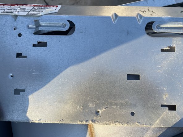

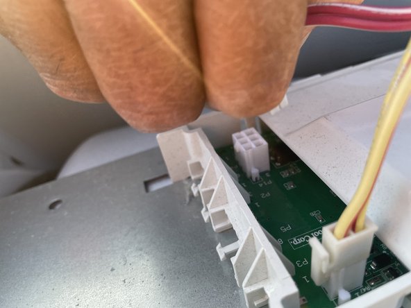

  4. Whirlpool Duet Dryer WED9200SQ1 Main Board Replacement: crwdns2935265:04crwdnd2935265:01crwdnd2935265:03crwdne2935265:0 Whirlpool Duet Dryer WED9200SQ1 Main Board Replacement: crwdns2935265:04crwdnd2935265:02crwdnd2935265:03crwdne2935265:0 Whirlpool Duet Dryer WED9200SQ1 Main Board Replacement: crwdns2935265:04crwdnd2935265:03crwdnd2935265:03crwdne2935265:0

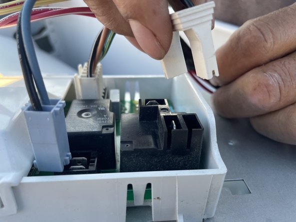

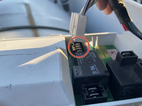

    • Remove all the circuit wires from the circuit board. Grab the circled wire to remove.
    • Remove the other wires.
    • Work at an angle with the metal mount still inside the dryer.

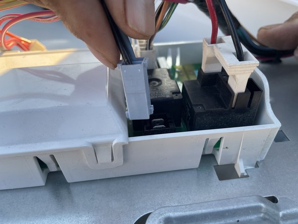

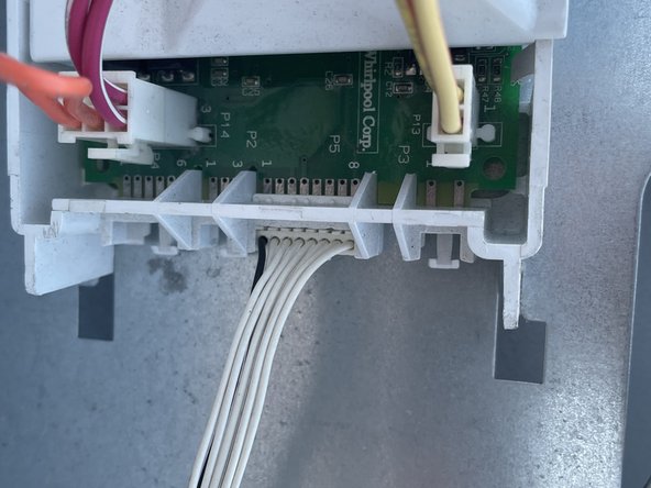

  5. Whirlpool Duet Dryer WED9200SQ1 Main Board Replacement: crwdns2935265:05crwdnd2935265:01crwdnd2935265:03crwdne2935265:0 Whirlpool Duet Dryer WED9200SQ1 Main Board Replacement: crwdns2935265:05crwdnd2935265:02crwdnd2935265:03crwdne2935265:0 Whirlpool Duet Dryer WED9200SQ1 Main Board Replacement: crwdns2935265:05crwdnd2935265:03crwdnd2935265:03crwdne2935265:0
    • Keep removing the wires until every wire is disconnected from the old circuit.

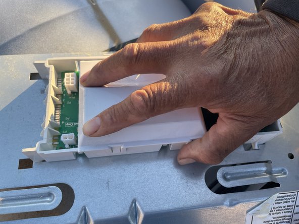

    • Once you've disconnected the wires, the wires should look like this in the image.
  7. Whirlpool Duet Dryer WED9200SQ1 Main Board Replacement: crwdns2935265:07crwdnd2935265:01crwdnd2935265:03crwdne2935265:0 Whirlpool Duet Dryer WED9200SQ1 Main Board Replacement: crwdns2935265:07crwdnd2935265:02crwdnd2935265:03crwdne2935265:0 Whirlpool Duet Dryer WED9200SQ1 Main Board Replacement: crwdns2935265:07crwdnd2935265:03crwdnd2935265:03crwdne2935265:0

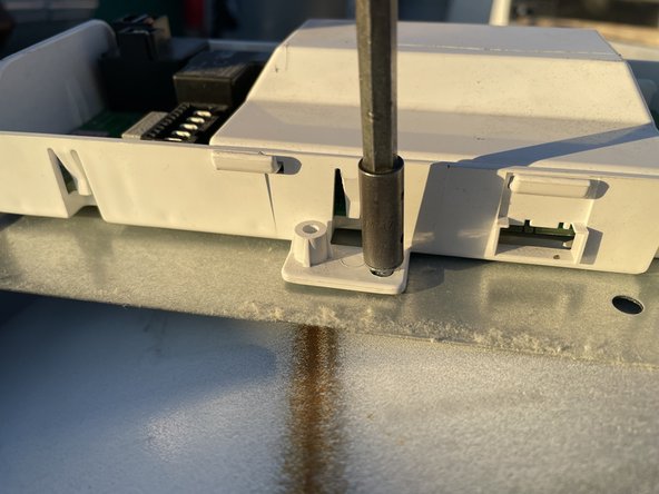

    • Use a T5 Torx screwdriver to remove the 6.3mm screw.
    • Use your hand to grab the old circuit and move it from the left to the right to get the circuit removed.
    • There should not be anything on the board.

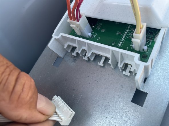

  8. Whirlpool Duet Dryer WED9200SQ1 Main Board Replacement: crwdns2935265:08crwdnd2935265:01crwdnd2935265:03crwdne2935265:0 Whirlpool Duet Dryer WED9200SQ1 Main Board Replacement: crwdns2935265:08crwdnd2935265:02crwdnd2935265:03crwdne2935265:0 Whirlpool Duet Dryer WED9200SQ1 Main Board Replacement: crwdns2935265:08crwdnd2935265:03crwdnd2935265:03crwdne2935265:0
    • Use the new circuit to put in the board. Ensure the two white hooks are connected to the metal base.
    • Use the T5 Torx screwdriver to screw the 6.3mm screw to the new circuit attached to the metal board.
    • The new circuit shouold be tight to the metal

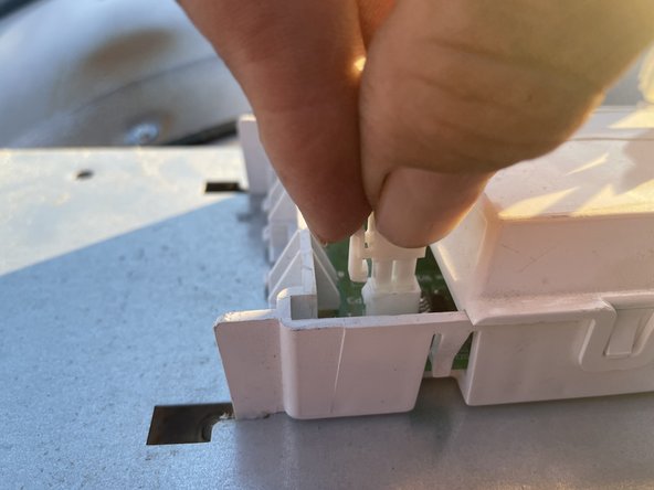

  9. Whirlpool Duet Dryer WED9200SQ1 Main Board Replacement: crwdns2935265:09crwdnd2935265:01crwdnd2935265:03crwdne2935265:0 Whirlpool Duet Dryer WED9200SQ1 Main Board Replacement: crwdns2935265:09crwdnd2935265:02crwdnd2935265:03crwdne2935265:0 Whirlpool Duet Dryer WED9200SQ1 Main Board Replacement: crwdns2935265:09crwdnd2935265:03crwdnd2935265:03crwdne2935265:0

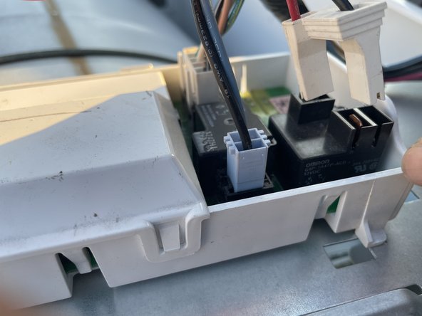

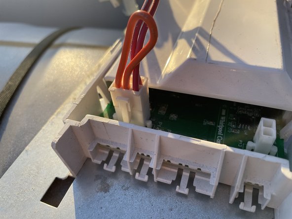

    • Attach the orange and red wires into the circuit.
    • Do to the same for the other wires

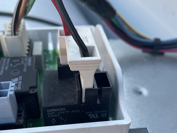

  10. Whirlpool Duet Dryer WED9200SQ1 Main Board Replacement: crwdns2935265:010crwdnd2935265:01crwdnd2935265:03crwdne2935265:0 Whirlpool Duet Dryer WED9200SQ1 Main Board Replacement: crwdns2935265:010crwdnd2935265:02crwdnd2935265:03crwdne2935265:0 Whirlpool Duet Dryer WED9200SQ1 Main Board Replacement: crwdns2935265:010crwdnd2935265:03crwdnd2935265:03crwdne2935265:0
    • Insert the red and white wires into the circuit.
  11. Whirlpool Duet Dryer WED9200SQ1 Main Board Replacement: crwdns2935265:011crwdnd2935265:01crwdnd2935265:03crwdne2935265:0 Whirlpool Duet Dryer WED9200SQ1 Main Board Replacement: crwdns2935265:011crwdnd2935265:02crwdnd2935265:03crwdne2935265:0 Whirlpool Duet Dryer WED9200SQ1 Main Board Replacement: crwdns2935265:011crwdnd2935265:03crwdnd2935265:03crwdne2935265:0
    • Refer to the image for where to insert the wires.
