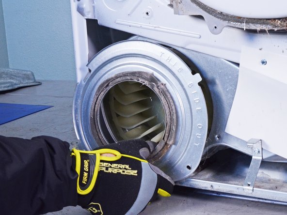

  26. Whirlpool Dryer Blower Wheel Replacement, Unfasten the blower cover: crwdns2935265:026crwdnd2935265:01crwdnd2935265:01crwdne2935265:0
    • The blower cover is the round plate that serves as the inlet to the blower.
    • Unfasten the blower cover screw.
  27. Whirlpool Dryer Blower Wheel Replacement, Remove the blower cover: crwdns2935265:027crwdnd2935265:01crwdnd2935265:02crwdne2935265:0 Whirlpool Dryer Blower Wheel Replacement, Remove the blower cover: crwdns2935265:027crwdnd2935265:02crwdnd2935265:02crwdne2935265:0
    • Lift the blower cover slightly and slide it to free the tabs which hold it in place.
    • Remove the blower cover.

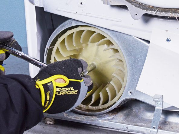

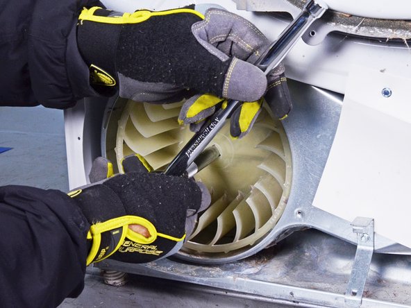

  28. Whirlpool Dryer Blower Wheel Replacement, Secure the blower wheel: crwdns2935265:028crwdnd2935265:01crwdnd2935265:01crwdne2935265:0
    • Move to the rear of the machine to access the drive shaft.
    • Hold the drive shaft with an adjustable wrench on the hex portion of the drum drive pulley.
    • The threads on the blower wheel are left-hand threads. The wrench must be installed to the left of the pulley to keep it from rotating counterclockwise.
  29. Whirlpool Dryer Blower Wheel Replacement, Remove the blower wheel: crwdns2935265:029crwdnd2935265:01crwdnd2935265:03crwdne2935265:0 Whirlpool Dryer Blower Wheel Replacement, Remove the blower wheel: crwdns2935265:029crwdnd2935265:02crwdnd2935265:03crwdne2935265:0 Whirlpool Dryer Blower Wheel Replacement, Remove the blower wheel: crwdns2935265:029crwdnd2935265:03crwdnd2935265:03crwdne2935265:0
    • Use a socket wrench with an extension bar and no socket to fit into the square hole on the blower wheel.
    • Turn the wheel clockwise (to the right) to free it enough to remove it by hand.

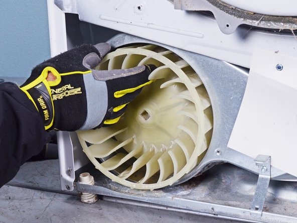

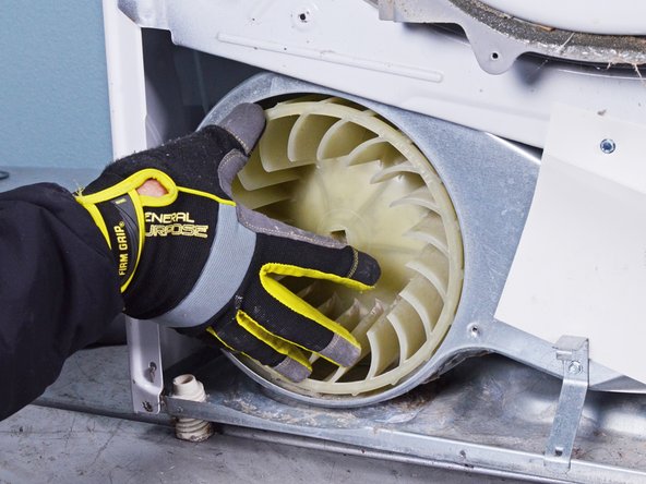

  30. Whirlpool Dryer Blower Wheel Replacement: crwdns2935265:030crwdnd2935265:01crwdnd2935265:03crwdne2935265:0 Whirlpool Dryer Blower Wheel Replacement: crwdns2935265:030crwdnd2935265:02crwdnd2935265:03crwdne2935265:0 Whirlpool Dryer Blower Wheel Replacement: crwdns2935265:030crwdnd2935265:03crwdnd2935265:03crwdne2935265:0
    • Rotate the blower wheel clockwise by hand until it's free from the motor shaft.
    • Remove the wheel from the blower housing.
