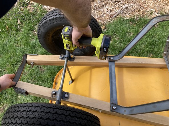

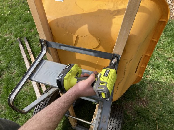

    • Remove the screws from beneath the handles to detach them from the wheelbarrow.

  5. Wheelbarrow Handle Replacement: crwdns2935265:05crwdnd2935265:01crwdnd2935265:03crwdne2935265:0 Wheelbarrow Handle Replacement: crwdns2935265:05crwdnd2935265:02crwdnd2935265:03crwdne2935265:0 Wheelbarrow Handle Replacement: crwdns2935265:05crwdnd2935265:03crwdnd2935265:03crwdne2935265:0
    • Turn the wheelbarrow shell on its side and put the bolts though the shell and handle.
    • Attach the legs, axel assembly, and wheel guard to the shell and handles.
    • Keep all screws loose until all pieces are in place.
    • Tighten all screws.
